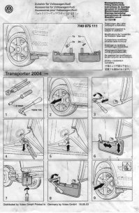

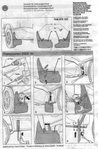

Whilst I have some attention, instead of starting a new thread.. mud flaps, am I reading right that the fronts are a bolt on, bolt on affair.. but the rears screw into the sides of the bumper i.e. its a permanent edition
Sorry cant help you with those as not fitted them to mine. Sounds logical though as pictures show the rear ones set back from the wheel arch. Maybe just fit the front? they prob have more effect than the rears anyway.
I was think of just doing the fronts if that is the case although I can see the rear bumper is having a hard time without mud flaps and is starting it to look a bit peppered so not sure what to do.
Both front & rear mudflaps are fitted with two small brackets. The rear appear to have one bracket fixed to the bumper & other to the body or a bracket under the vehicle. Front has two brackets one fixed through the plastic wheelarch liner & other directly to the body behind the liner.
I seem to recall someone saying that factory fitted mudflaps are somehow different to the VW aftermarket ones, don't know details.
found this whilst googling
