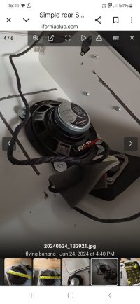

I've just removed my knackered rear speaker. Does anyone know what will fit directly in its place. Obviously better quality too like alpine. The speaker comes back to life if I press the cone but then stops again when I release it. Also is there a reason there's holes in the back plate? Seems odd. Is it worth sound deadening over the holes?
