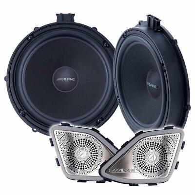

If anyone is after the speakers, eBay are doing another 20% offer and the same seller I used is taking part which means you can get them for £255 delivered.
They also have the sub on offer, but as the discount is limited to £75, it's £424

Also I just checked the 8 inch set for T6. Same offer but comes in at £279.
