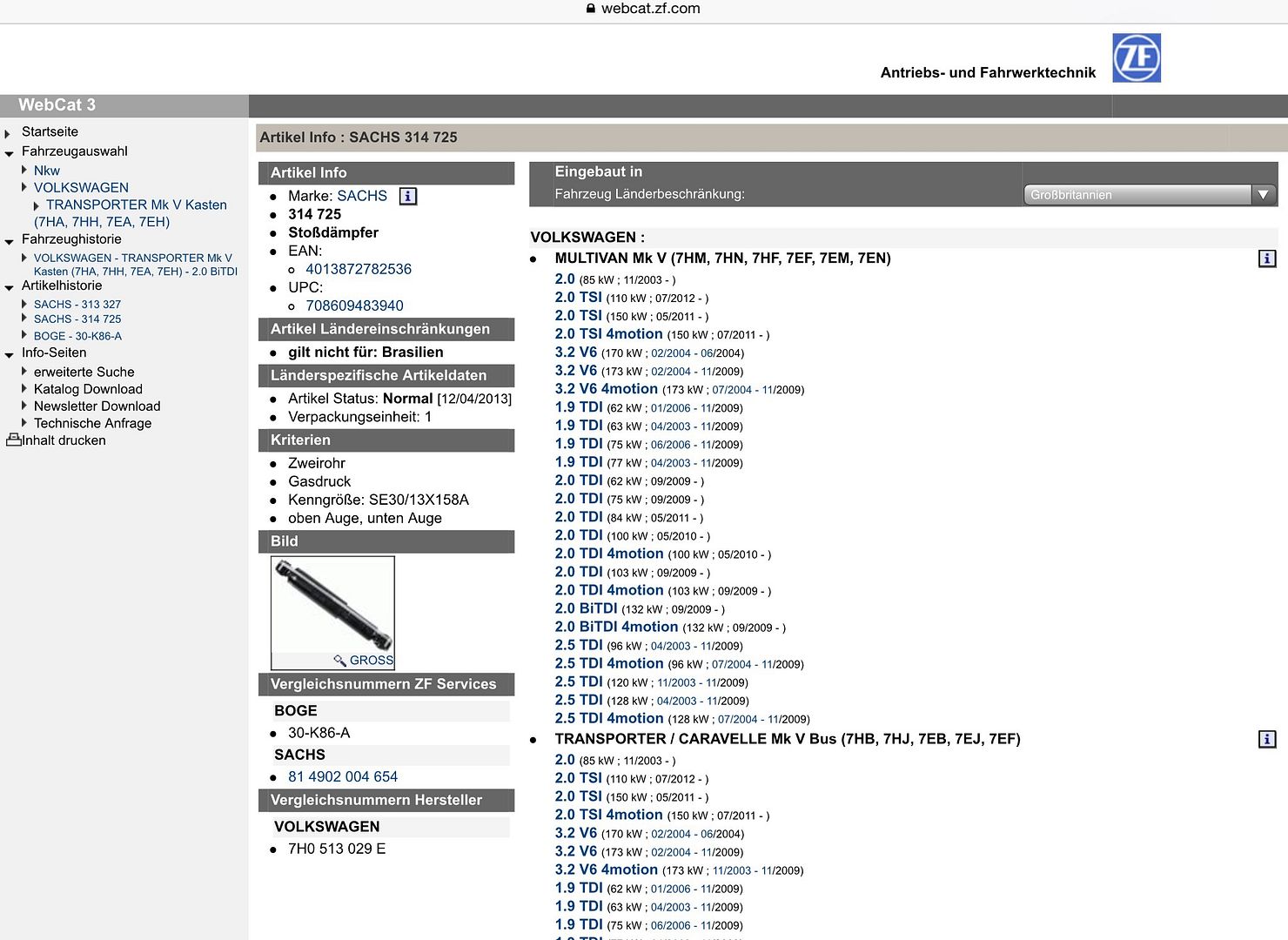

Hi, hmmm that seems a good find, thank you. How can I be sure they will fit my 2015 Cali, seems they only say they are compatible up to 2010 models ??
No difference for the facelift models, just a quirk on their website.
Here's the fitment list from the SACHS catalogue, Webcat (ZF.com)
(california based on multivan platform)
