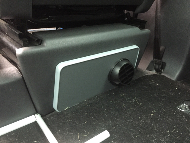

I had the vent installed on the base of the seat. I believe there is a more complicated install that is possible with a vent in the B Pillar (like factory) but its a longer install so I opted for the seat base.

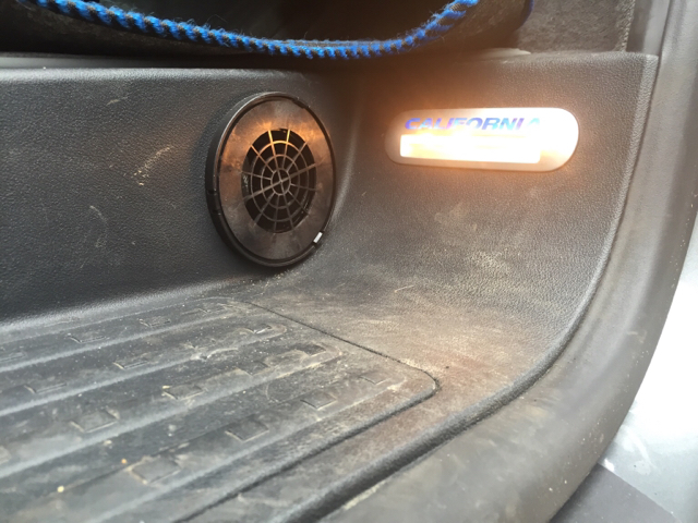

If you can, please post some pictures. Thanks

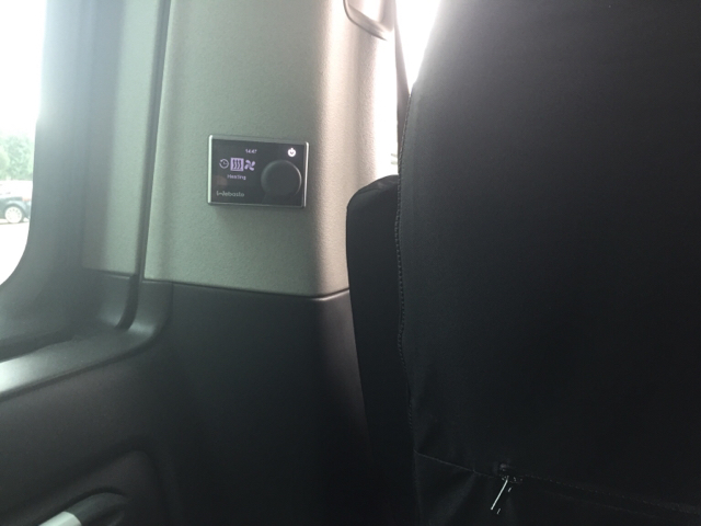

Control panel
Intake
Excuse the dirty floor. ;-)
Heater panel that I opted for.
Nicely done.

Does the heater panel have to be used as I have seen examples where the round swivel vent is fitted into the plastic base of the seat (similar to the inlet in the foot well step)without the need for the panel ?
Cheers
Will.
We discussed that option on the day and I wasnt sure how clean it would look as the plastic isn't straight and has curves in it. I opted for the plate to be added.
The plastic seat panel is relatively cheap so I could look to reinstall it with just the vent at a later date.
OK thanks Matt, It looks a nice neat job either way, I am looking to get one in my Beach, hence the interest !

If you're ever nearby Will, feel free to come have a look or a demo of it, I'm near Coventry and at the Stratford meet. This model you set the temperature and time of the heater to run or can programme it to come on at various times. Its better than the heating in my house and a little more controllable than the standard one. ;)
I was especially pleased with the location for the controller on the Beach. We discussed multiple options including dash mounting (wasnt any suitable space really) , on the seat base (too low down?) and on the A pillar above the alarm button on the drivers door (maybe a little hard to get to from bed) . We agreed on that location.That was what I liked, they treated my van like it was theirs and discussed all the options to ensure I was happy.
Cheers
Will.
This is how I redid mine:
The vent is mounted on a bit of grey painted plywood that has been fixed to the existing seat trim. Needed to do this to get a large enough flat area for the diameter of the vent.
The original fitter (not Slidepods) replaced the whole grey seat trim with a nasty bit of hardboard covered in black carpet. Hated the look of it.

Very nice job :thumb methley. How much time did it take?
A couple of days taking it steady, as it involves cutting holes in just the right place in the base of the b-pillar and step! As I have a Webasto coolant heater I could tee into the fuel supply for that, otherwise it involves dropping the fuel tank to install a new fuel pick-up. Fitted a remote to the Webasto while I was at it so can warm/defrost the van from the kitchen in the winter!
