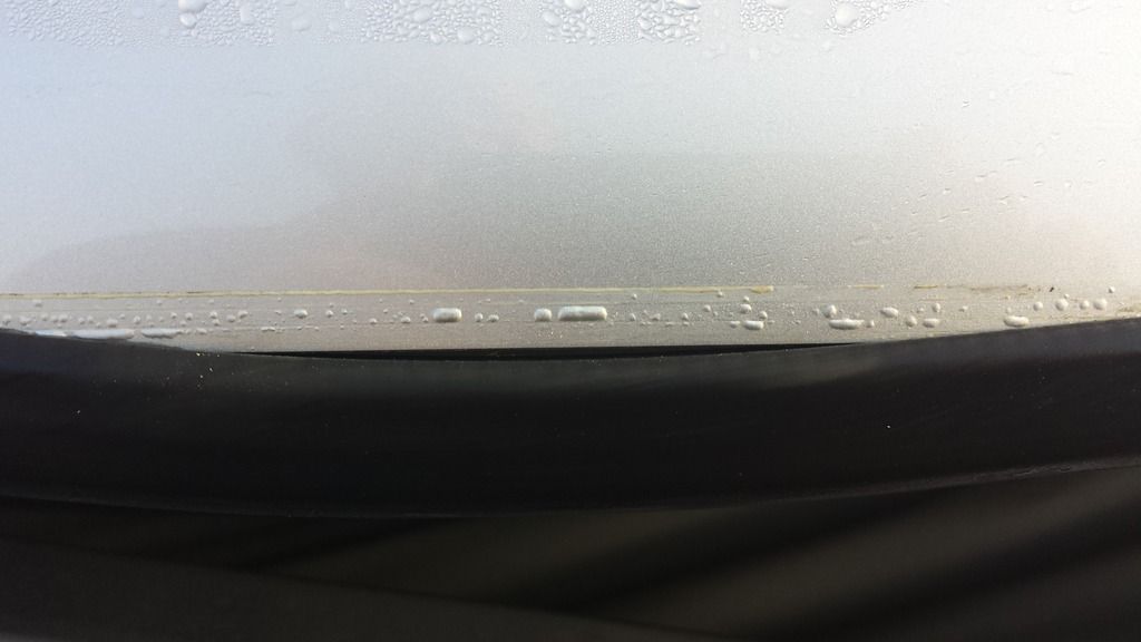

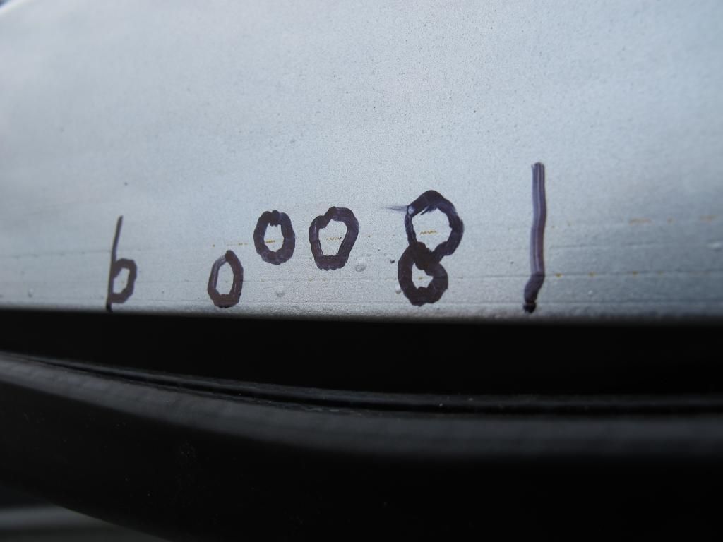

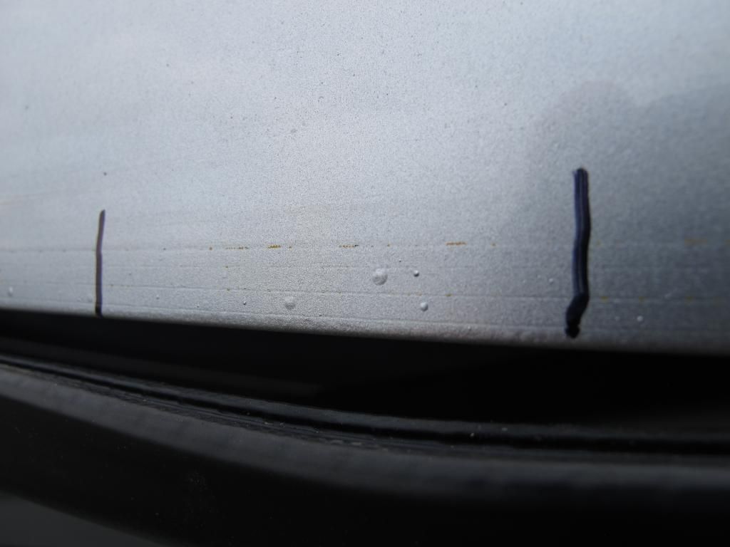

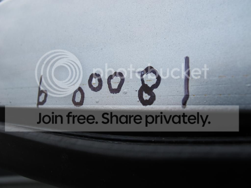

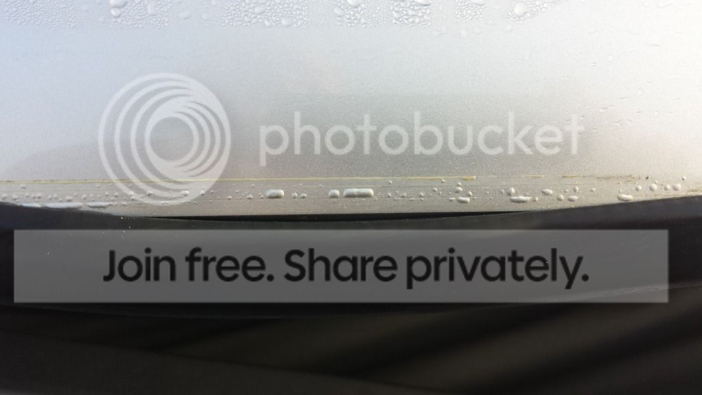

We had the raising section of the roof repainted about this time last year (2015) due to the paint bubbling underneath the seal so I thought I would have a look and see what was happening.
Slide off 2 sections of the rubber seal, 1 each side, and this is what I found,

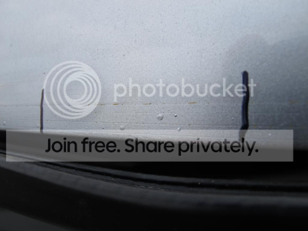

This is what it looked like in 2014,
Oh dear, very disappointed looks like the "new" painting procedure doesn't work.

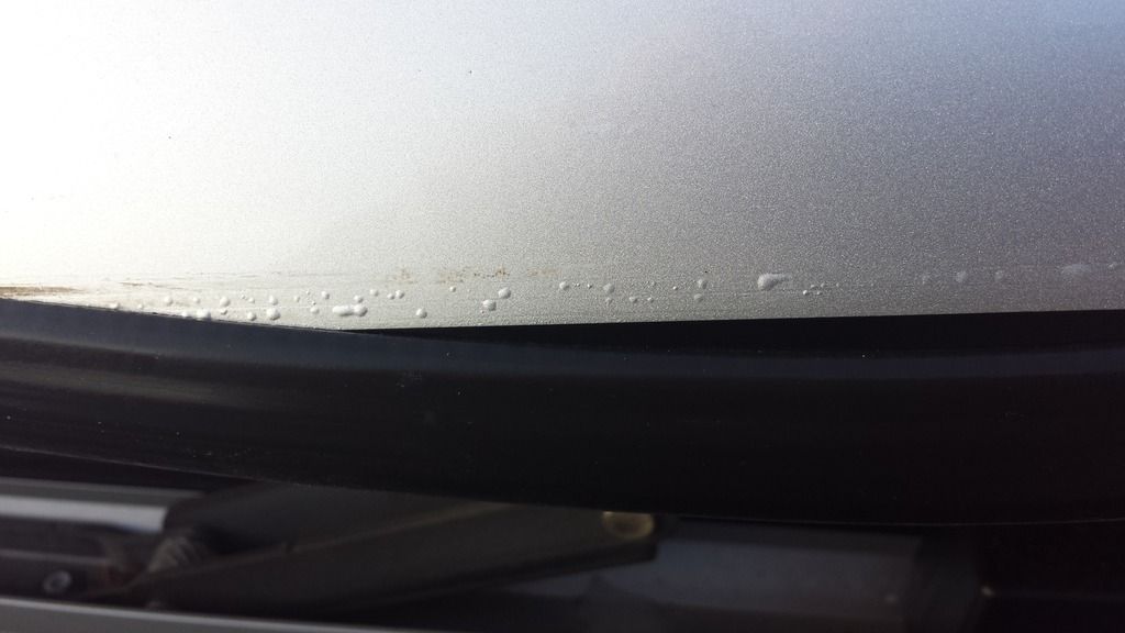

Thanks for the heads up on this, I have just been out to check mine as the roof work was carried out by Shorade in March 2015, (our van is a 2011 and had foot rot on main roof and front panel) anyway, low and behold I also have bubbles under the rubber seal as well !
I suggest everyone goes and looks under their seal, mine was quite tough to remove as it felt like it had been glued but once I got the first bit off it did peel away to reveal the horror
So what now?
Take pictures of problem and vehicle to include reg number, also vin. Send to VWCS with full details. Copy in Dealer that carried out the Warranty work.
Was the repair carried out at one of the approved body shops that repair the front section? VW have been getting the elevating roof repaired at local body shops, some of these are not familiar with the paint process for aluminium. I notice from the photo that there is no protective tape fitted like Shorade fit after their repair.

Just checked mine which has gone as well :sad Ours was also done at Shorade last year, is this why they glued it down in the hope we would not notice?

Looks worse than round 1
The repair was carried out by the Lister Group Bodyshop at Coventry http://listers.co.uk/Bodyshop/Coventry (not one of the famous four) as suggested by VWCS who are approved by an impressive list of vehicle manufacturers including Audi, Seat, and VW. I'm sure the repair was carried out to VWs specification.
Please note that 2 other respondents to this thread with a second bout of corrosion were repaired by Shorade who are one of the "famous four"
Looks like the Shorade tape trick doesn't work!
The procedure at one repairers I spoke to was to glue the rubber seal down after the fix. .

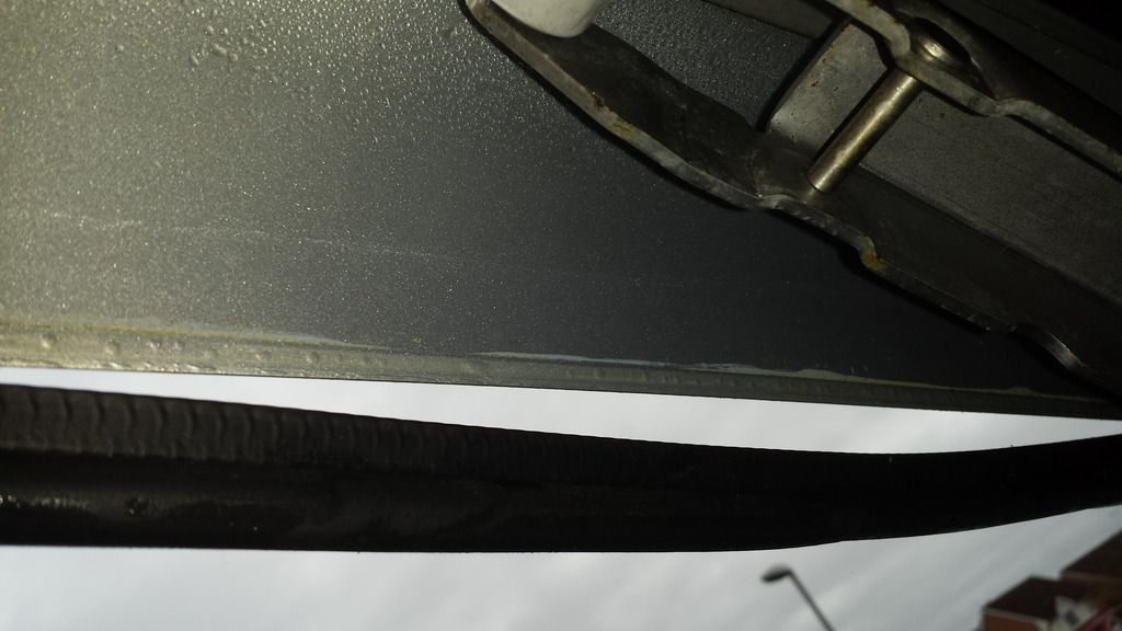

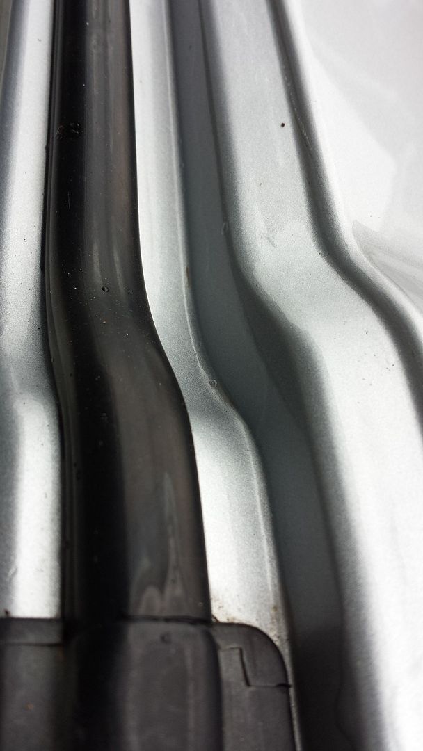

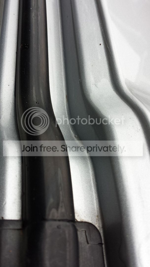

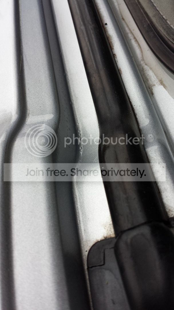

Had another look under the seal on the raising roof and this is an image from inside the roof. Plenty of bubbles to be seen where the rubber has been pulled down. The bubbling at the top of the image behind the lifting mechanism is condensation.

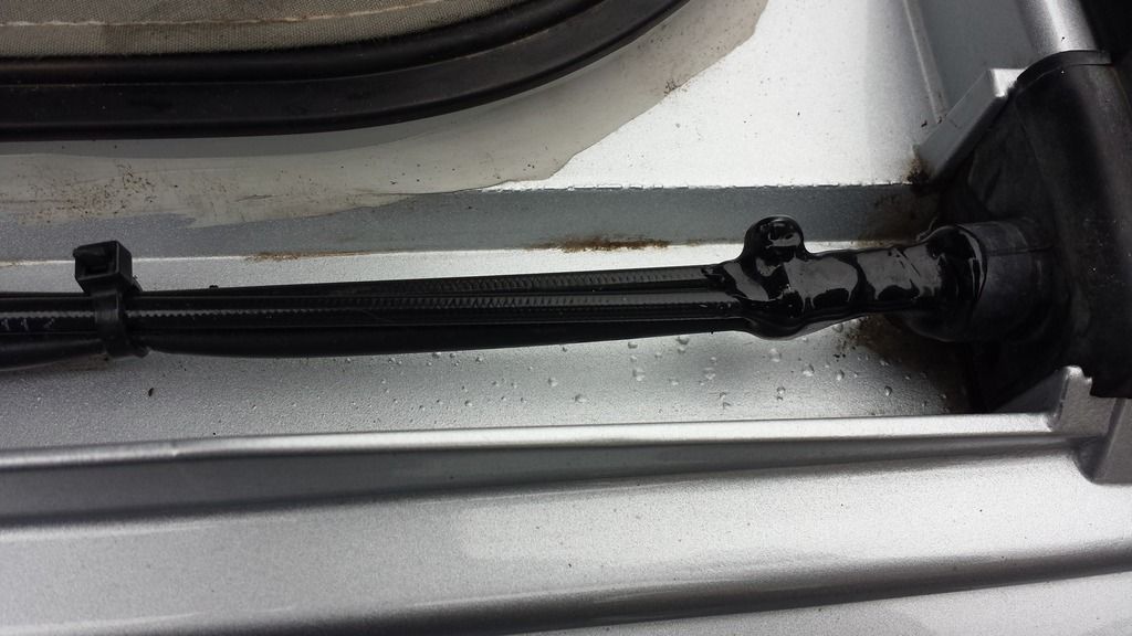

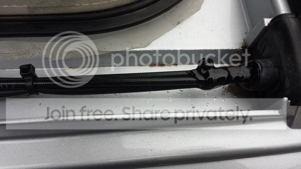

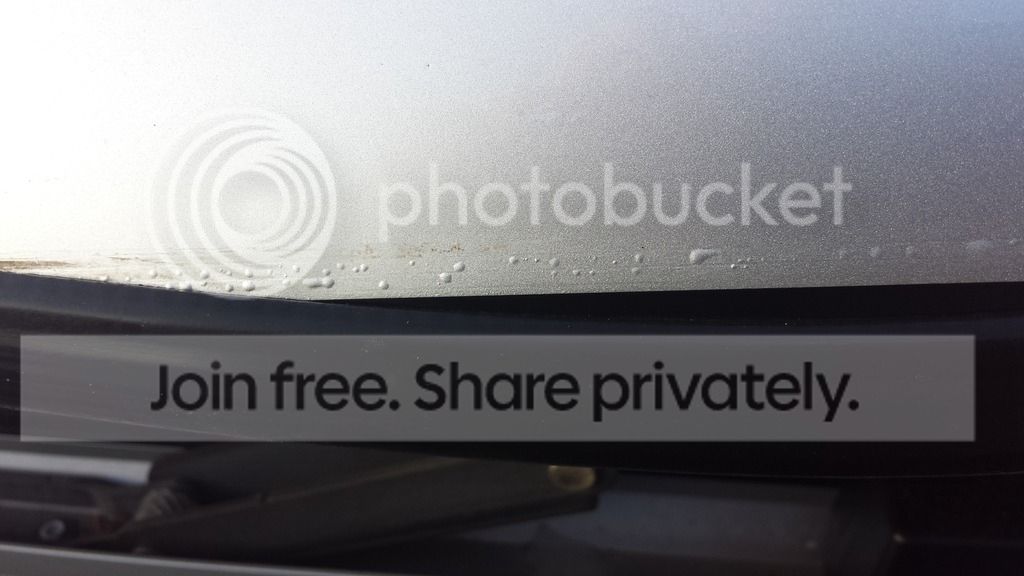

Whilst I had the roof partially raised I gave the front fixed section of the roof a thorough inspection and found bubbling paint in four places.
Underneath the right and left black plastic covers over the pipes/wires/front drain holes.
To remove these covers look at this thread.http://vwcaliforniaclub.com/threads...of-front-drain-holes-and-for-corrosion.12701/

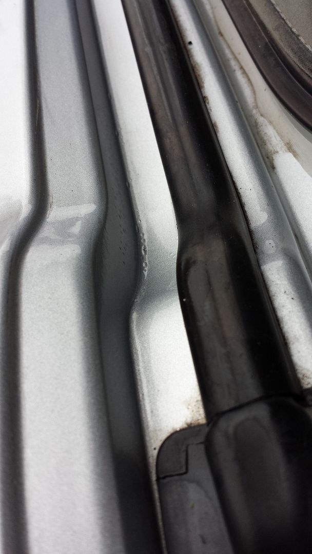

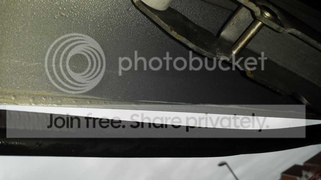

Bubbling of the paint can also be seen on the front fixed section of the roof above the windscreen. Again on both the right and left hand sides. These are not visible with out the roof being raised.
A line of bubbles in this image
A single bubble in this image.
This is on a Jan 2014 Cali made after the problem with front section was supposed to have been fixed!
The front panel bubbles look worse than on my cali WHICH VW REFUSED TO REPAIR hope VW read these posts.
I thought, but could be wrong, that the fix was implemented mid 2014. Either way report it with all the information ASAP.
