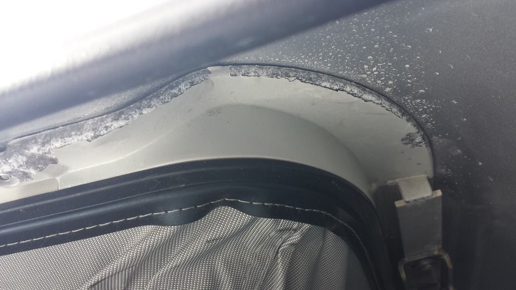

I was going to bond my two solar panels to the roof of my Cali today & thought I should first check to see if the corrosion has reoccurred.
I cleaned the seal & roof where it seals to & above the awning .
When I checked the seal I found at the N/S rear corner the metal in the seal is now protruding & has rusted. The only thing stopping it from touching & rubbing on the roof is the rubbing tape Shorade fitted.
I also have dark patches under the rubbing tape, not sure what this is, could be the primer showing through where it has not been covered properly with top coat ?
So looks like I shall not be bonding solar panels to my roof & will be contacting both Shorade & VWCS on Monday to get the seal replaced.
Fortunately my front panels seems to be OK at present.
Contacted Shorade via their website. Will wait to see what they say before contacting VWCS.

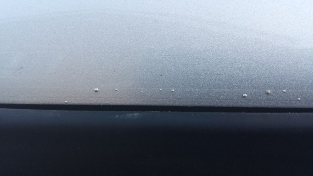

Sad to report that our Cali has got bubbling paint yet again on the raising section of the roof.
The roof was repainted early 2015, that failed.
Repainted again in July this year and bubbling yet again.
Also spotted this so well peeded of to the say least.
What an absolute disgrace.
We have contacted VW.
