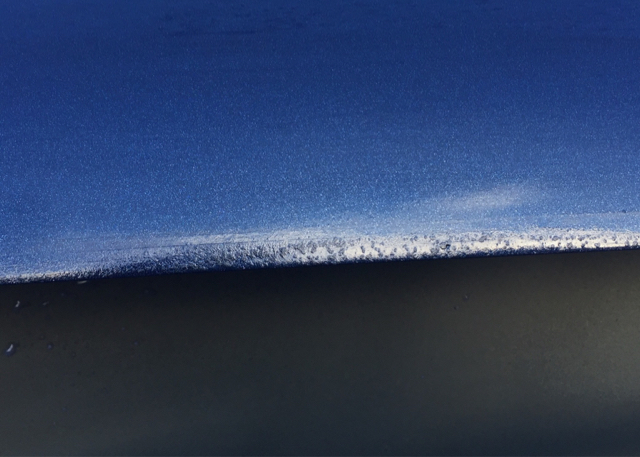

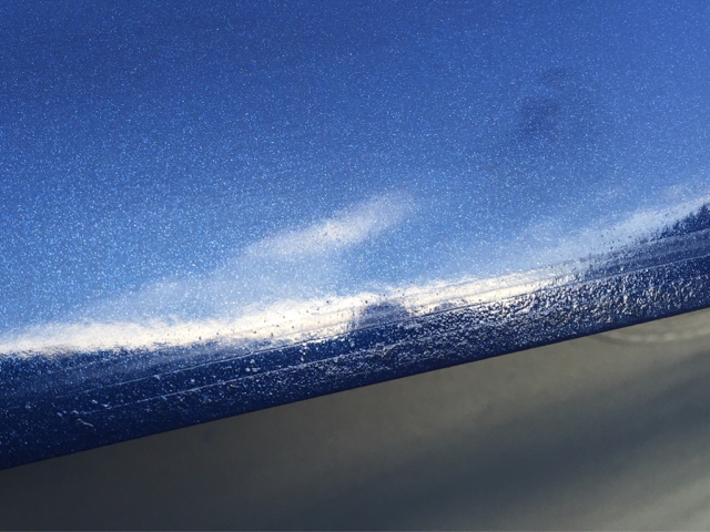

Had a look at mine over the weekend. Not sure what to make of it. Not the same bubbles as before but some rough areas as if it's lots of tiny bubbles that have burst.
Repair was done by Heritage about a year ago. On a positive note the front section looks fine.
