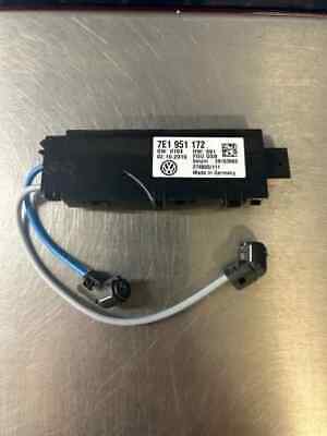

I have removed the small section, is the heater plug-ions on this?
How do I reset the control panel?
That is the alarm sensor unit
As above.
