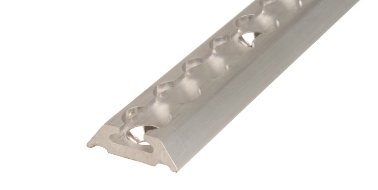

I have a Reimo pop top and want to mount 2 solar panels on it.
Looking for advice on what rail tracks are available to bolt to the roof.
I have no need to fit a roof rack on the track. I understand that the roof is rated for 40 kilos the solar panels weigh considerably less.
I have found that t track on eBay seems to stop at 48 inches 122cm. The 2 panels next to each other measure 49.5 inches 126cm.
Looked at some airline track or L track I have some internally in the van to move the Rock and roll bed but it is not surface mount type. Rather the flush type routed into the wooden flooring.
Does anyone know of a uk supplier of suitable track.
I can find it in Germany but the carriers won't deliver to the Uk as the track is 3990mm long.
Cheers

Have a look at Kari Tek roof rail systems,
If the underside of the roof is not accessible (ie 1 side elevating roof), then attach using wellnuts:

Is there a particular reason you want to fix the panels using a rail system?
Most conversions using fibreglass roofs seem to just bond the panels to the roof using Silkaflex adhesive.
The California seems to have rails as standard.
Speaking to Roger about one of his systems they are fitted to a frame so I needed to be able to mount it to the roof.
Reading some of the forum posts people who have glued panels to the roof have had problems when the air has expanded under the panel.
Also since the panels are less efficient when hot I thought the gap under the panel would be preferable.
If we are in Europe I thought the panel glued to the roof would get the upstairs too hot.

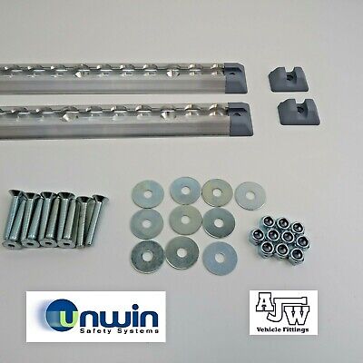

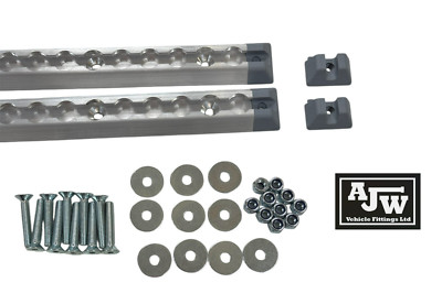

I have looked at electrical uni track as that is available in stainless steel.
The items I found first were the following
https://www.ebay.co.uk/itm/Ankerpun...n-System-Airlineschiene-Racefoxx/283535233688
a german company https://www.loadrestraint24.com/search/?q=kerl+500 has the equivalent at much better prices
they have bolts that will fit in airline track
then enough length for 2 panels
The electrical track was from https://directchannel.uk.com/unistr...ange-a4/Unistrut-Type-Stainless-steel-channel
