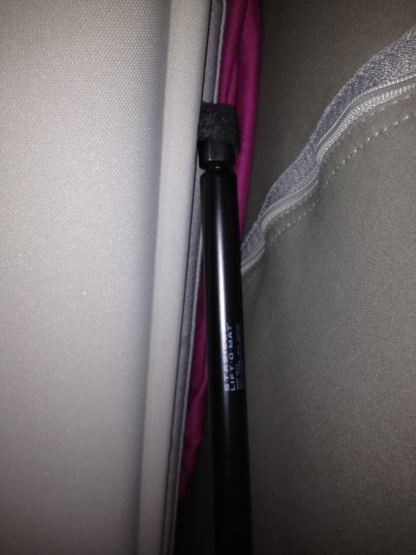

I found a rubber grommet on the floor yesterday so started the hunt for where it had come from but no joy as yet. What I did notice was that the bed struts in the roof sit close to the frame and it looks like they have been rubbing. There is some felt tape on the end of the struts so I guess they know it's an issue.
C6corvette and Stu - any chance of a photo or two please? I'm having a senior moment and can't seem to visualise where respective felt pads are/ should be. Many thanks.
Graham,
The gas strut for the upper bed, top section where it fits to the bed base.
Aha! Thanks very much. As soon as it stops raining for long enough I will give this a go.
