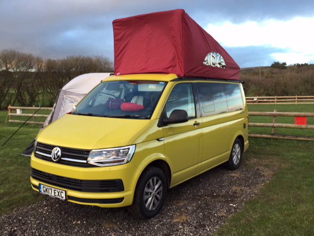

When we chose our topper, we went for the Comfortz roofless external topper from the VWCC shop. Our reasons were:
Pro's:
We wanted to be able to use the topper with roof rails and a roof box.
The external topper protects the OEM canvas and the roof mechanism.
It was relatively easy to put up by one person (after a bit of practice).
The OEM canvas and roof mechanism stays dry, so you are not closing a wet roof onto the upper bed.
It's easy to fold up, even if wet. The carry bag is waterproof, but I tend to loose fold it into a dry bag or a bin liner if it's wet and then dry it out at the earliest opportunity.
It does seem to keep the cold draughts out in windy weather.
Cons:
Can be fiddly to put on, but it does get much easier with practice.
It is easier to put up with 2 people and a set of small steps will help.
It does make the interior a bit dark, but we got the one with 3 windows so that helps.
Overall we are pleased with our purchase, which has been successfully tested in heavy snow and rain.
Hope this helps
