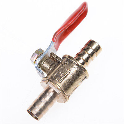

So noticed the back of the van soaked. Everytime I ran the tap the valve at the back was spraying out. So I plugged in the shower to stop this happening til i got home but then find the shower hose has also failed. It's failed where it bends sharply in its foam holder. I had to do this Bush fix with a bolt to bung up the water pipe. The pipe was an absolute pig to get off. Anyway question is how much is a new shower valve and where can I get one. Also a new shower hose and has anyone trimmed the foam to enable it to sit better in the holder?
Found a new shower hose on ebay. Got 3.50 off so £31.50. Going to have a look at the valve at home. May be able to adapt a gas valve to fit

So this is the part I now need. I've tried cleaning it out with foam etc. Operated the valve with a screwdriver. It won't have it and refuses to seal

Mine had literally just stuck in the open position. All it needed was “operating” a few times by inserting and removing the shower hose. But that was in a brand new van so it had probably never been used. Hope you get it sorted.

a squirt of wd40 or a silicone lube into the brass connector and as Phil mentions - operating a few times by inserting and taking out the connector will do the trick. Also ensure that any jubilee clamps are tightened.
