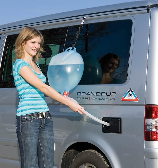

The Brandrup 10L water carrier to fill the California water tank came with fittings to use that rail. Not had any problems so far.
3.8 gallons = approx 17.3 L
Brandrup also do a 20L water carrier with the same hanging strap for the C rail.
ps: Brandrup also do a 20L solar shower version.
