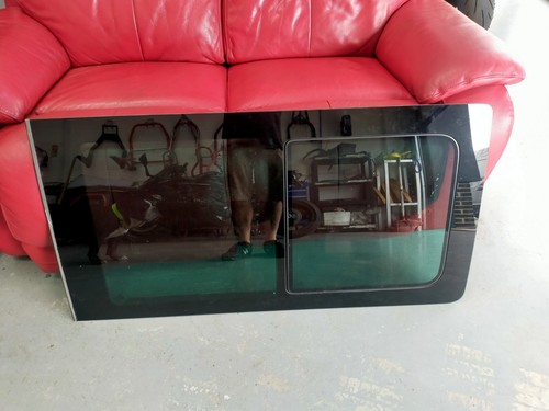

Have found a used genuine sliding window on ebay from a 2016, looks the same design with no drain in the bottom track
Thanks, Does the same window fit wether it's a sliding door or a fixed panel or are they different?
Matching the tint seems my main concern now.
The one you’ve found on eBay … sliding window with no drain?
