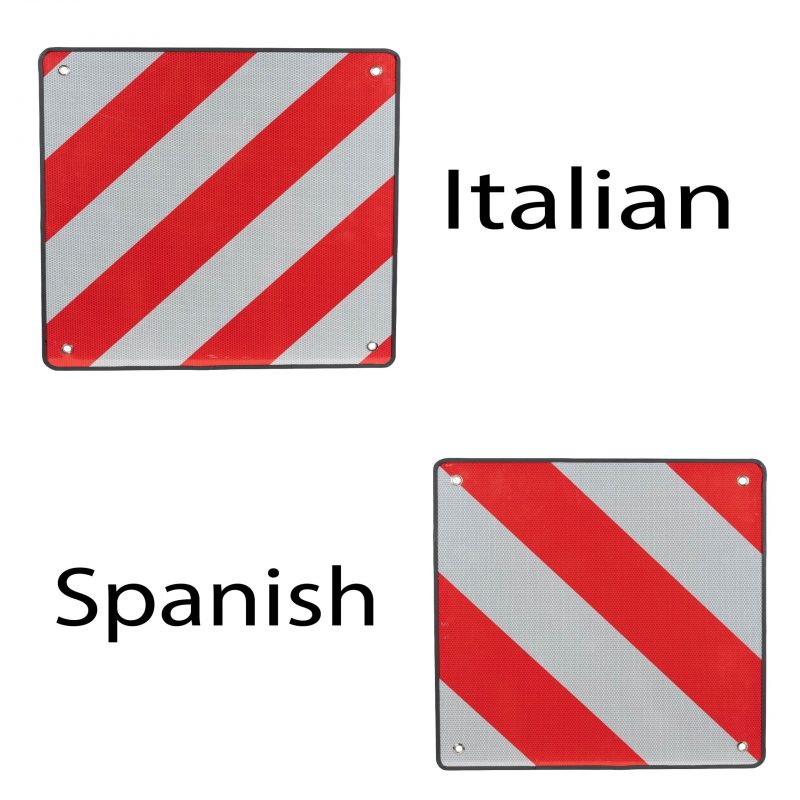

Yes, but I think driving without is, at worst, a very minor infringement. It could become more of an issue if someone rear ended you, and they tried to blame the lack of a warning board.
Italy requires five stripes, Spain requires three stripes. You can buy a reversible board from the club shop.
Just back from a few weeks in Italy with two bikes on a Fiamma rack but no striped board. I had one years ago but realised that not everyone used them there, and I’m sure I read on this forum a while back that they are not a legal requirement in Italy? Need to check accuracy of this - don’t know about Spain?
