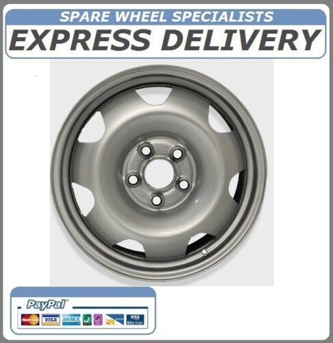

I’ve just collected a T6.1 Ocean with the sport pack that includes 18” wheels and doesn’t come with a spare or the carrier.
I bought a 17” steel spare from eBay and the official VW carrier from the club shop. I fitted them yesterday, with the tyre fully inflated.
The van would have come with 17” Davenports so the 17” spare will fit over the disc.
The tyre is 215x60x17. The diameter is within 3mm of the 18” tyre

Can I ask where you got this from? Struggling to find a spare steel wheel rim 17” anywhere!
Theres a chap in St Neots - 2 mins off the A1 who can do a full set of parts including tyre for about £200 but he won't post.
PM me if you want contact details. Its where I got my last one from in January.
Also, I bought mine new from Rackhams. I considered buying a used rim but then decided against it because you can't see hairline fractures, etc., in the rim, and driving down the road with a loaded 3.0T vehicle I didn't want any problems. So, I went new. Rackhams advised as to the rim size and tyre size to ensure proper load rating.
