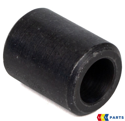

Looking for some help here I have a T6.1 with sport and obviously 18” wheels have no spare. I have a cradle, all the bolts and a wheel tire, but I can’t get the tire to fit. I understood the 235/55/17 would go cradle, but I just can’t get it go in. I’m on the lower holes of the cradle and still I’m about 25mm short of getting over the bolt. Cradle I bought did say for T5 but the part number when you search for it comes up as T6.1 as well so I’m assuming they are the same. I’m wondering if I deflated the tire whether it would fit obviously would need to use the compressor to pump it back up if I ever needed it.
Can anyone confirm the bold length on the left had bolt the one that stays in? I bought a 58mm but now thinking that maybe that’s and 25mm or so too short and would be used to pull the spare up if it where longer. The right one I bought a 52mm locking bolt IMG_0896.jpeg

Yep I think this is my issue I have a 52mm security bolt and a 58mm bolt with the safety lugs (the perm one) I feel both are too short I just need someone to confirm this is right but a good start would be to get one of those 90mm security bolts I think and that would all make sense as to why you also need this black spacers that go over the bolts. I’m struggling to find a longer than 58mm fixed bolt anywhere at the moment.

I have 235/55 17 tyres (inc spare) and the bolts for my spare wheel carrier are about 90mm long from the factory, plus 2 x spacers. I think you need longer bolts.

You could just use a plain non- captive bolt or 2 90mm security bolts as long as the L hand one is only slackened off to allow the carrier to slide sideways.

Actually, that is a very very good idea. When the tyre centre took my spare wheel out, the tyre fouled on the captive bolt - even with the bolt wound back up it still protruded due to the long spacer that’s held captive on the captive bolt. They ended up having to put some wood under the rear tyres to raise the rear of the van to allow clearance.
A second security bolt to replace the captive one would be the perfect solution as when the bolt is removed the spacer can also be removed and wheel would come out easily - thanks @WelshGas
Edit: I’m going to file off the existing captive bolt’s “wings” to enable it to be removed like a normal bolt. I only need the one security bolt.

Thank you, I have the 90.5mm security bolt in order now as you say the captive 90mm bolts seems no where to be found so will order a second security one I think it’s unlikely to ever fall out but suppose it’s possible to drill a small hole through it at the end and have a small split pin in there but seems a lot of effort.

Summary is if you have a Cali T6.1 possibly all variations and want to fit a 235 width 17” wheel underneath you need 90mm bolts ideally one security bolt and one captive bolt, the later seems no where to be found so at your own risk use two security bolts instead. Not forgetting the stupidly expensive (for what they are) spacers

Do have the spacers?
