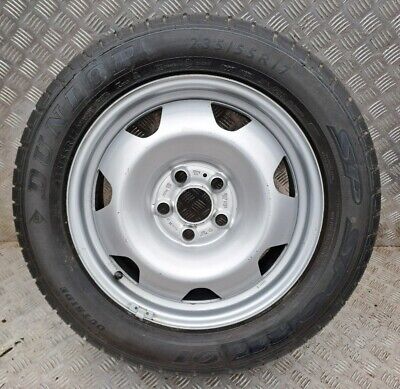

Should be ok but the link below is for a genuine VW 17" wheel with a new tyre at 2/3rds the price just check the load rating. If you don't mind a proper grubby spare wheel some like that are as low as £50.
Thanks I looked, now sold. I’ll keep looking.

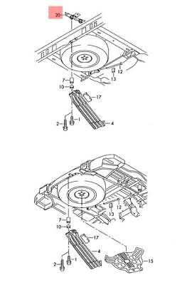

I do not have the mounting under the van to fit the 17". It is completely absent. I had one of those second take moments when I went to fix the SafeLock. Is this something any van centre could do?

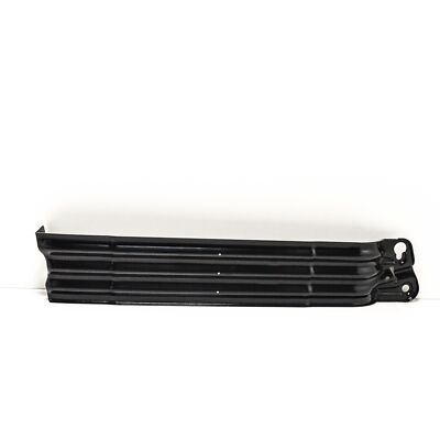

Get the cradle from eBay or the like & fit it yourself - its one wire pin to thread through 4 holes & 2 bolts to screw into existing captive nuts.

Yes but they will relieve you of a substantial amount of your hard earned money. The mountings for the carrier will be there, so you just need to buy the carrier and bolt plus the spare wheel.
Dumb question! Does that kit come with the pin and bolts?
Actually I’m not sure what that part is as the listing is deceptive and says you only get what’s highlighted in red.
It looks like the bracket is more like £100: give the club shop a call as they may do them cheaper with members discount and provide good advice.
This is the part

This is the part
OK, thanks. The club shop has it with all the fixing parts. I might go there because at least i know it has the mounting bits and is a genuine VW part. Thanks for your help.
Do it yourself - I paid 150 for a brand new VW steel tyre (17" - 235/55/17) and 80 for a brand new rack. Both on ebay. Took me 30 minutes to fit. Half the cost. Our Cali has the 18" fitted.

I have a 17" Alloy wheel with a 235/55/17 All Season tyre (non rotation directional) if required £100 plus carriage.
