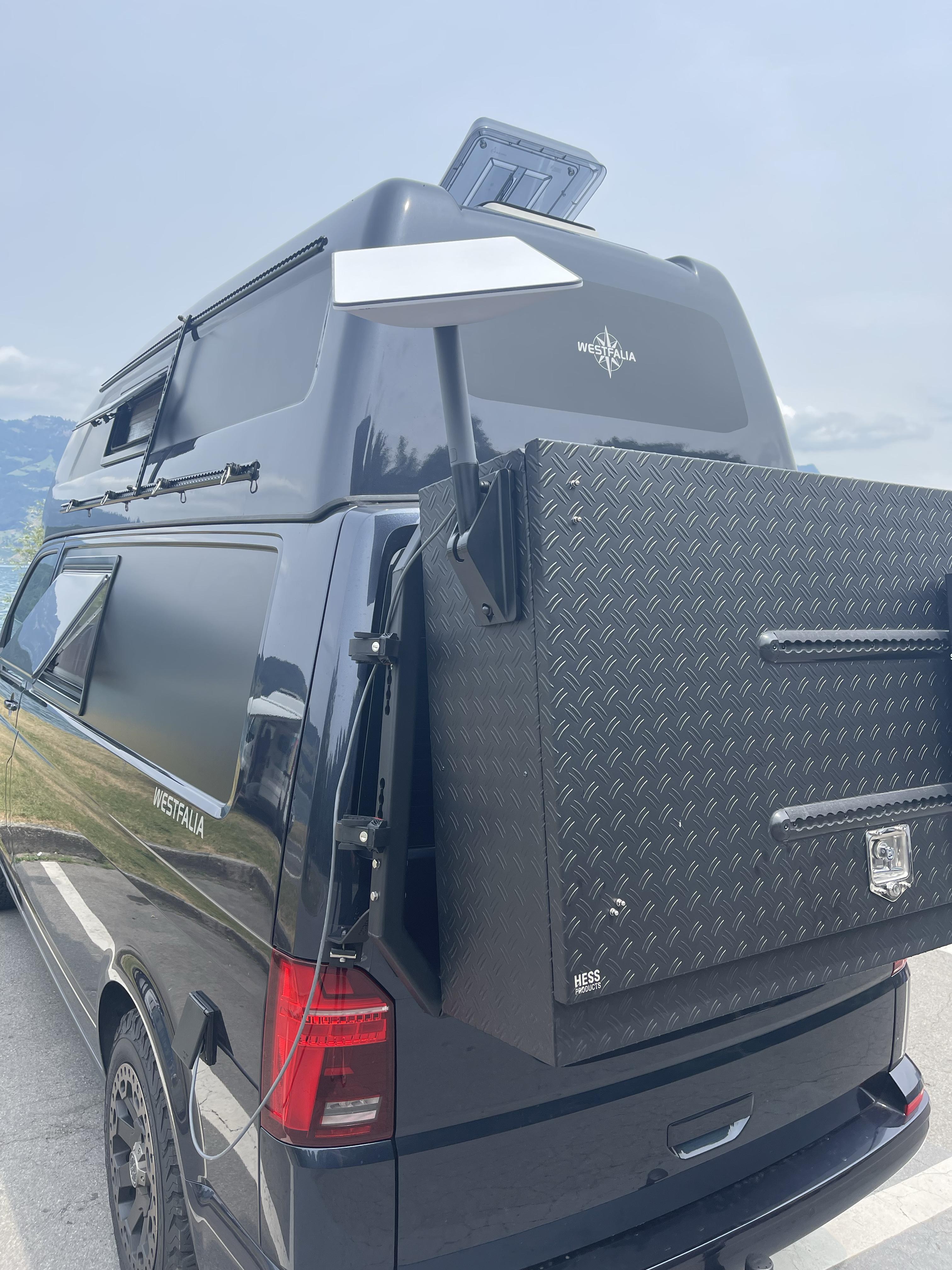

It moves around but I’m keeping an eye on it. In Switzerland it’s best to have it facing North East. So far I’m pleased with these results. Sitting high in the mountains of Pilatus with poor mobile 4G or 5G:

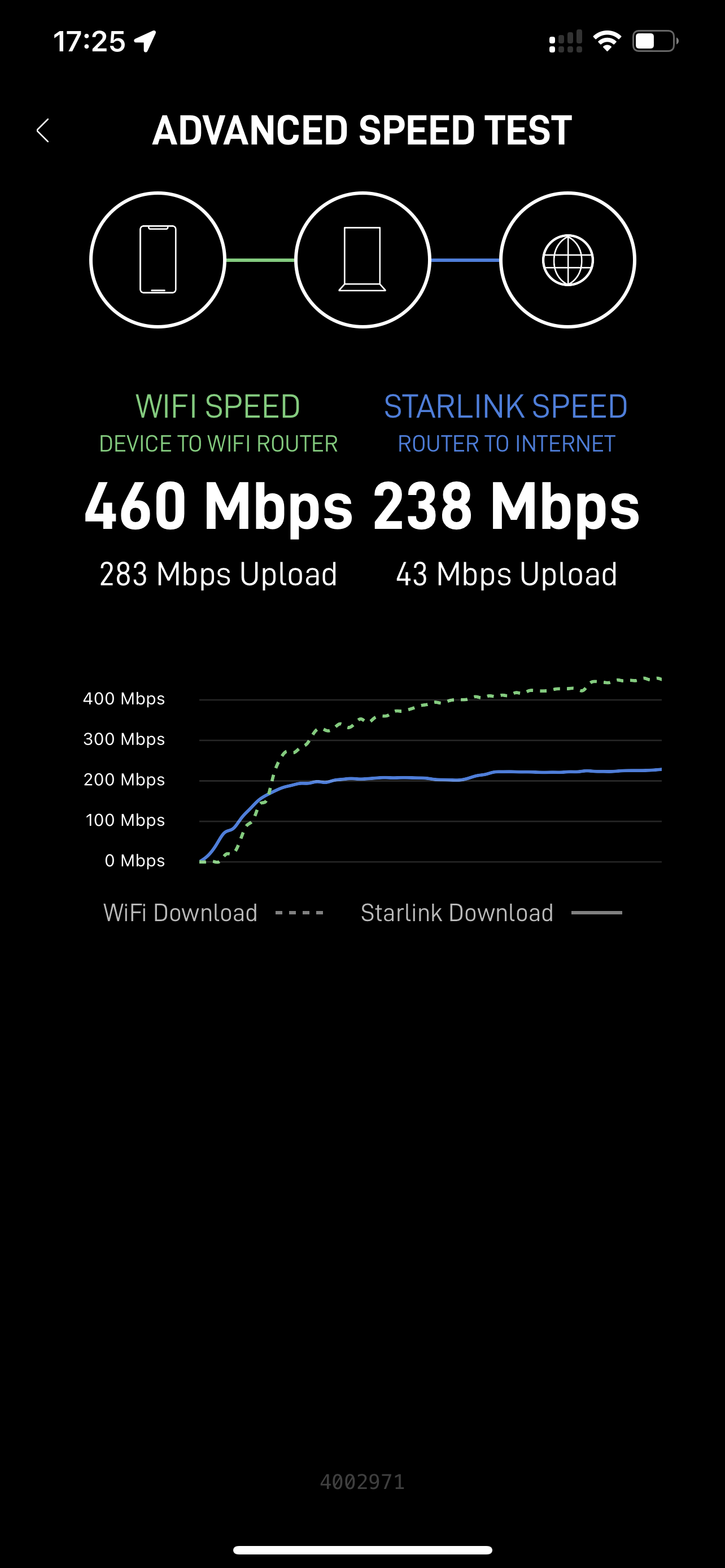

Another 5 minutes and I’m online with 193Meg from Dishy McDishFace.

I connected mine here with a pole mount adapter. Works in motion too at the moment. It’s under 2m if I take it off the pole mount. If you put it flat on the roof, when the roof is up it’s at 45 degrees, so not sure if that will work?

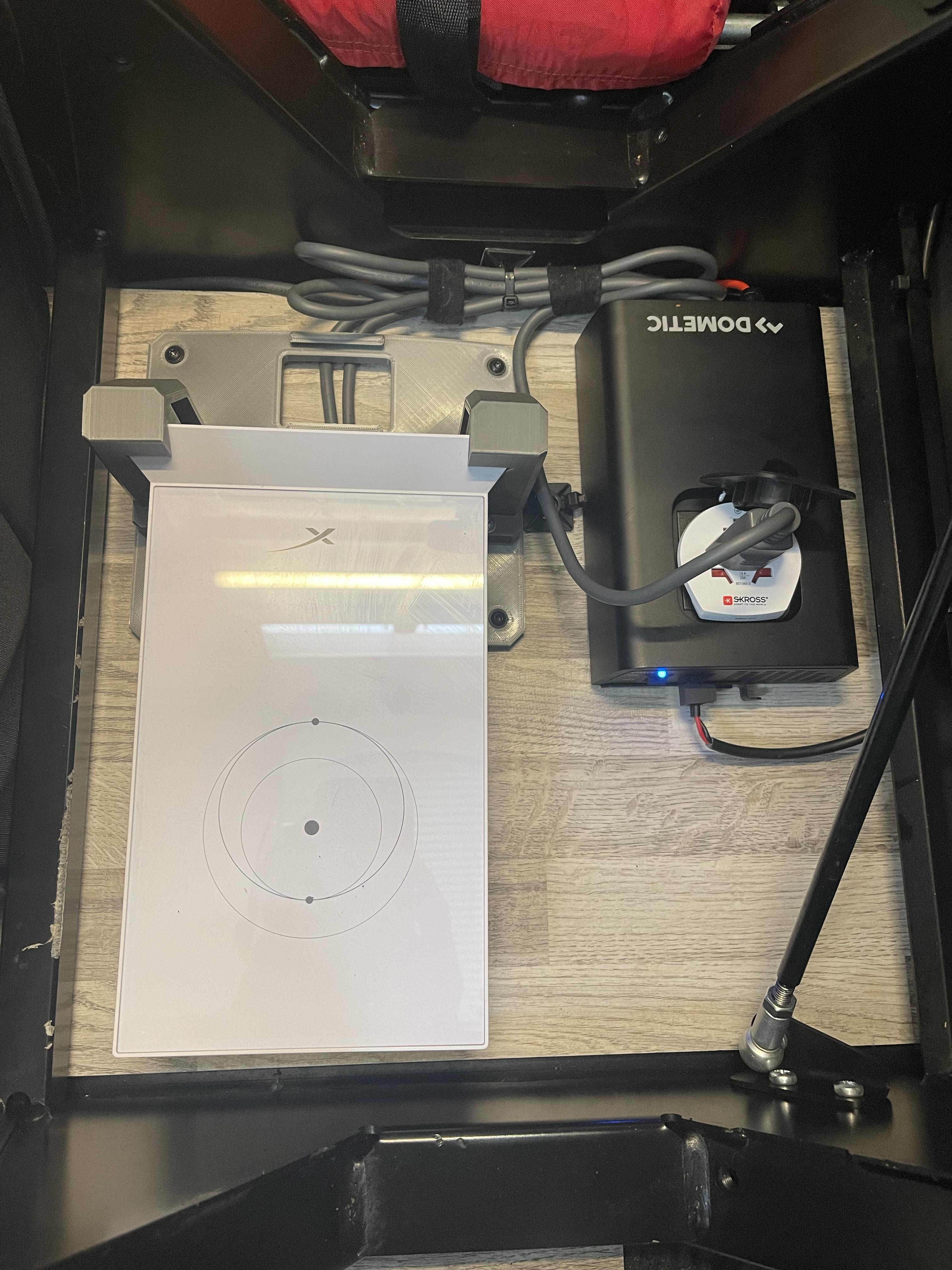

I just finished installing mine cleanly under my bench seat. I chose to use a Dometic 350w pure sine inverter dedicated for this alone as its super silent and efficient. That way I don’t need to have my large Victron powered up unless I need it for something else. I’ve seen average 40 watts from the batteries which is acceptable for me. No need to do a hack job 12v conversion using a different router. Also ran the cable out via my AC outlet on the outside of the van. Works great and can still use EHU.
