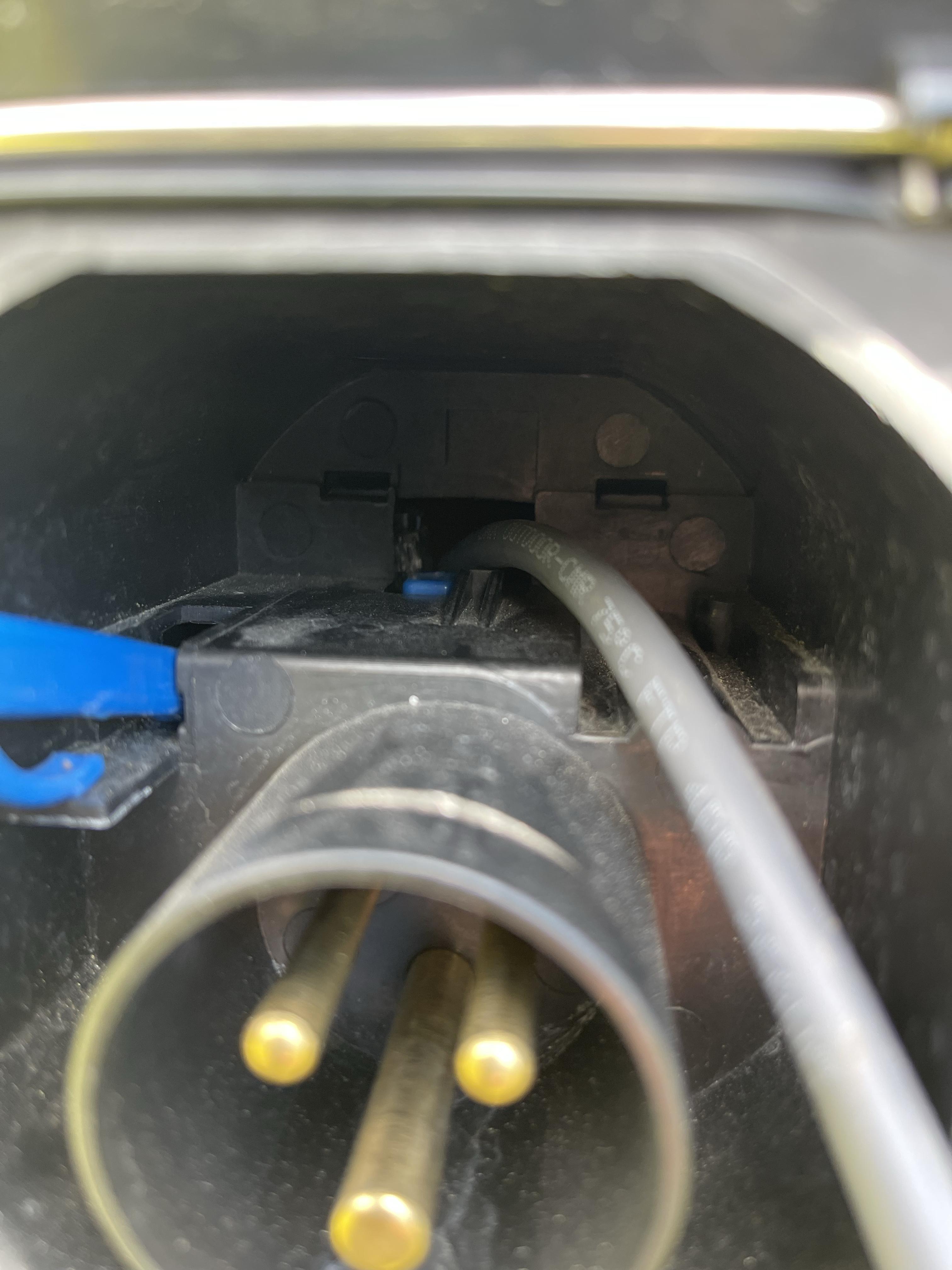

I went through the AC socket on the side panel. Removed it and cut a small notch to fit the plug through. Easy to pull out the cable I need and then retract it manually when done. Happy with this setup! Note this is on my Westfalia Club Joker but a Cali Ocean should work too.
And yes, I can still use EHU!

I haven’t bothered and it hasn’t been an issue for 2 months now with driving in some crazy conditions. When the AC door is shut it’s sealed up. If that’s something you want to do there are plug covers on Etsy. Or the ones that came with the cable (but small and easily lost).
It will never slip back into the hole. I removed the entire AC socket to make it small enough to squeeze it through, but it certainly won’t push back through easily.
And to clarify, once you remove the AC socket box it splits in 2 pieces. So the notch is mainly for easy sliding of the cable to retract and extend. I also lined the cutout with some window seal trim to prevent the cable from getting cut up on the plastic edges.

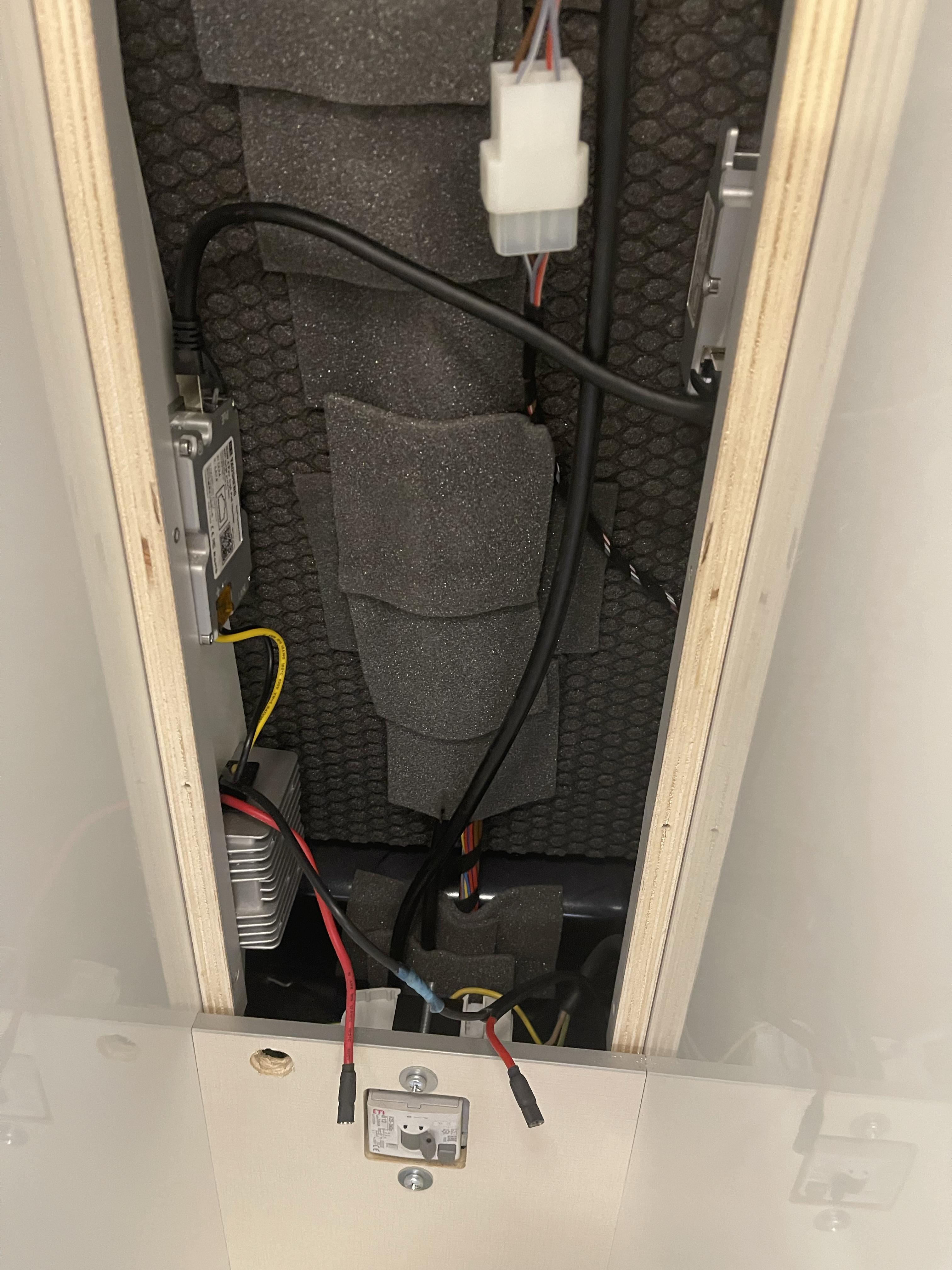

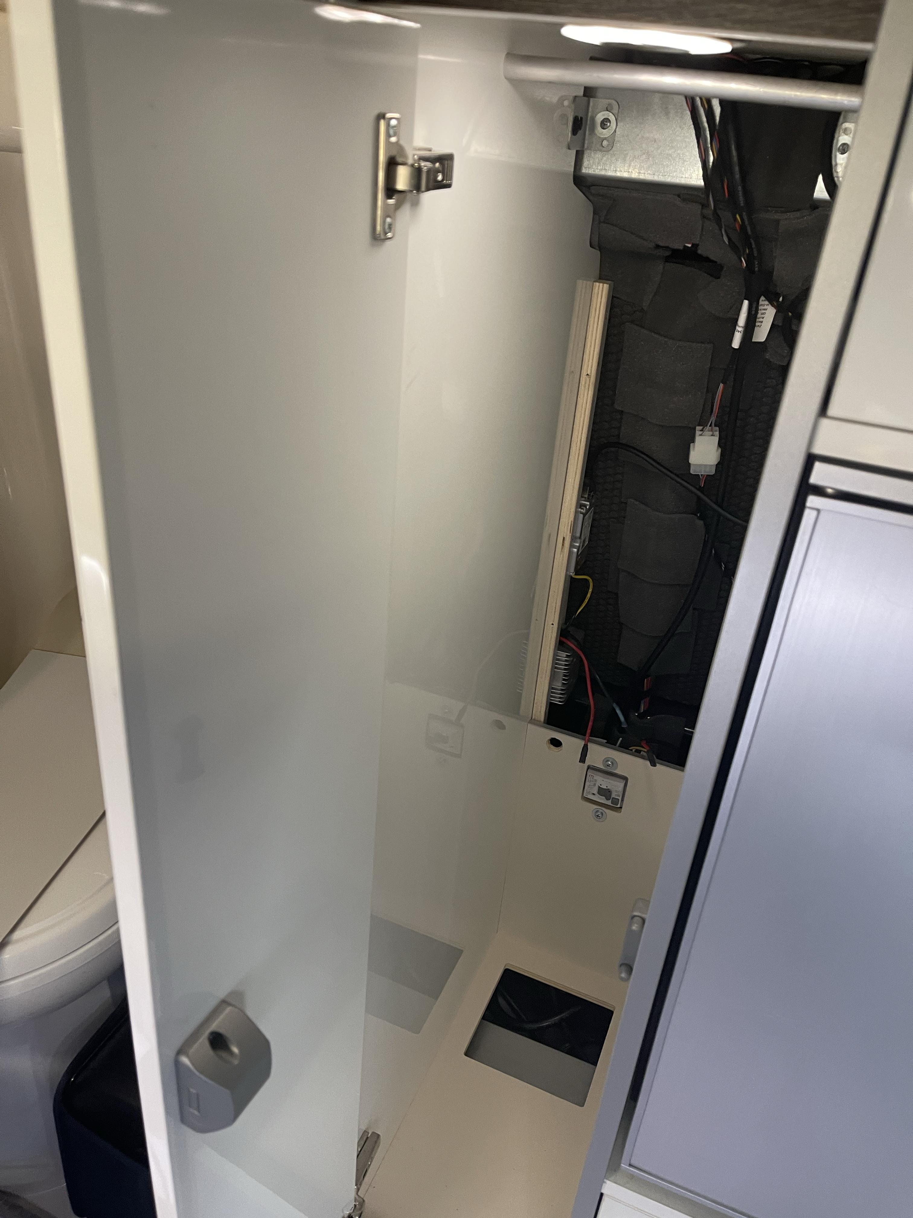

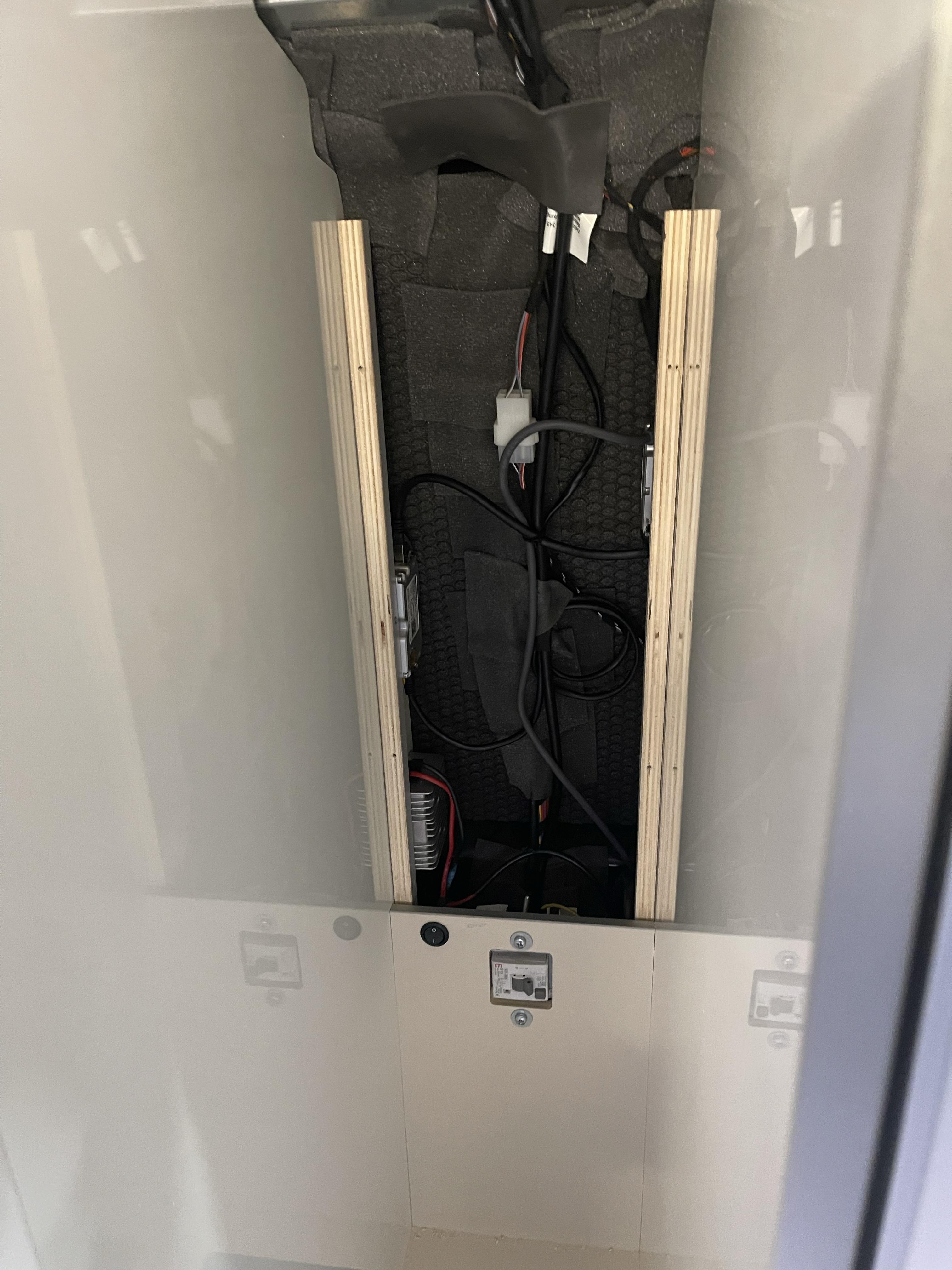

Today’s modification completed. Installed Yaosheng devices to convert to 12v and use my own router. Was a tight fit to install behind the panel in the wardrobe closet but happy with the end result! Looks to be saving about 10-15% power.
No cutting of the Starlink cable which is great! Happy to provide links to the kit if asked.
Final photo of install completed before closing it up.

Ordered mine from US Amazon as well and had my freight forwarder then send to me.
As long as it works right? However the Yaosheng kit is really nice quality and in a solid metal case. I didn’t want to cut any cables and their kit is superb!
Note you also need a 12-48v step up converter and I bought a Eufang that is 6A at 48v. That’s about 288 watts which is more than sufficient for boot up of the dish.

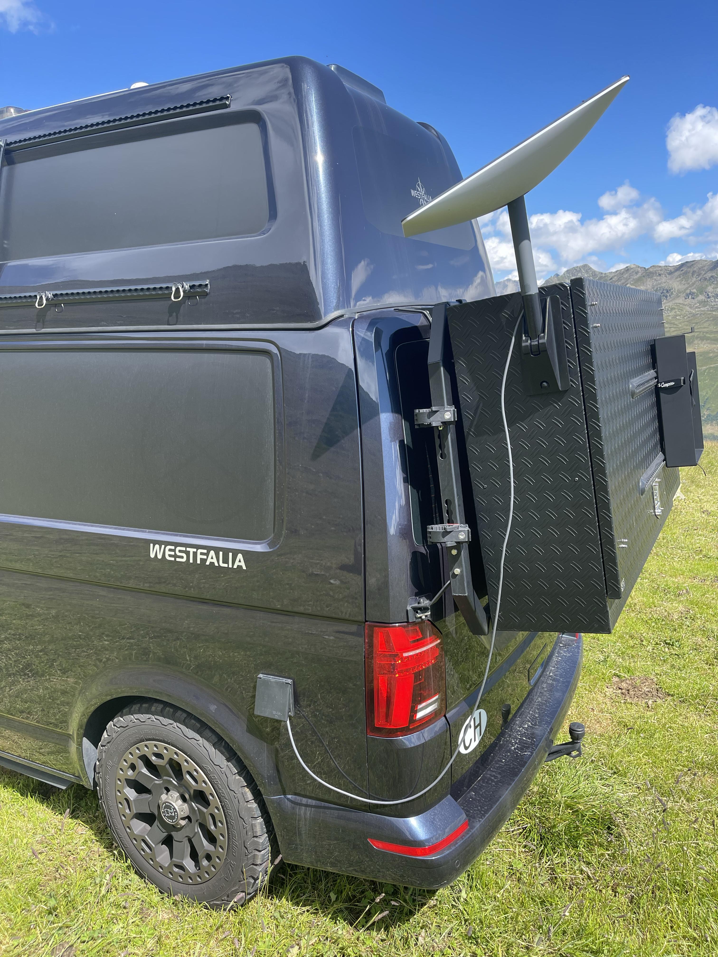

Any issues raising the roof with the Starlink weight and mount being on one side?
No issues, roof raises up straight on both sides.
Dishy weighs around 4.2 Kg and the bracket is 1Kg
I have around 30kg of Solar and brackets too.
So 35.2KG in total and the roof raises with no issues.
