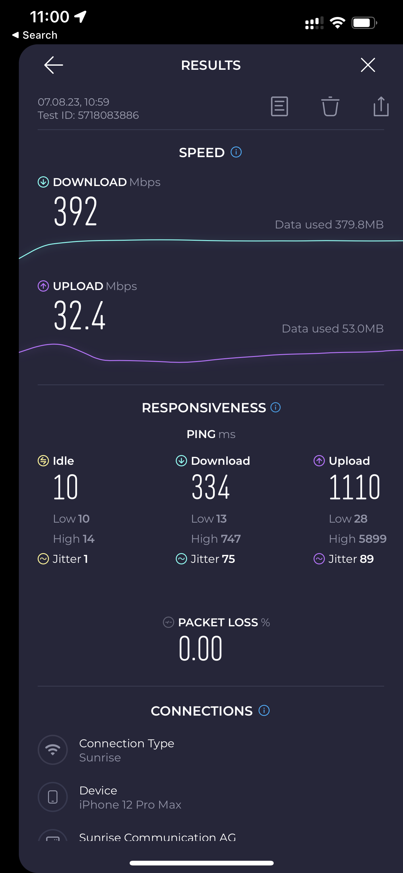

Quick 5G test this morning

I’m in Switzerland and use Sunrise. Have also used Swisscom and both work fine for me.
