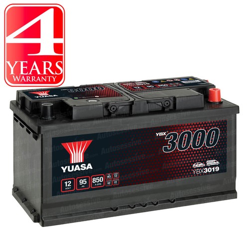

Recently fitted a new Yuasa YBX5019. No problem. About £100 inc delivery from parts for machines, were cheaper than Tanya. Was shipped directly from Yuasa.
