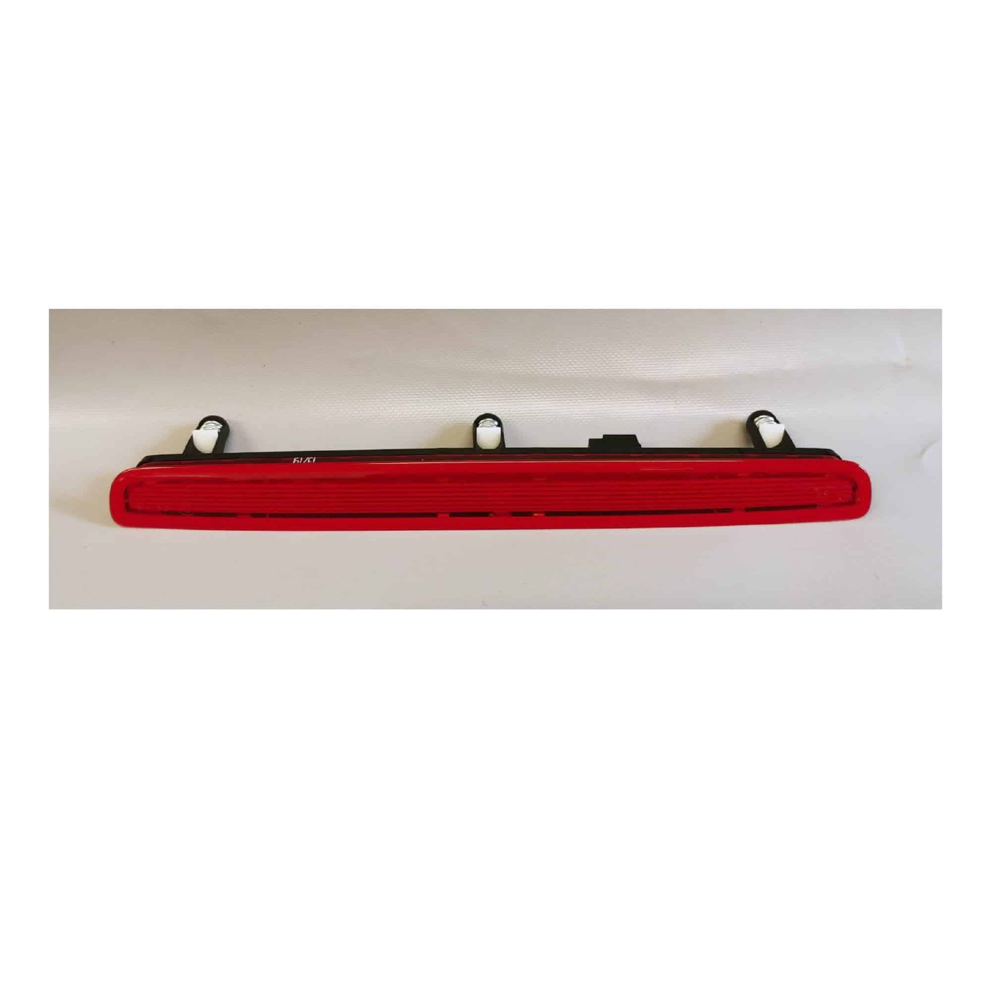

Just come home and the wife says our high level break light is missing, either it has fallen out or someone has stolen it :headbang
It's fallen out, T5 & T6 problem I'm afraid, very annoying but covered under warranty. Cover the hole temporarily to prevent water ingress.

One time we did find the fallen off unit, and it was not broken. However it was impossible to get it to click back into place - I assume you have to press from both sides to make it click together, and that will need trim taking off on the inside???
Lucky the LEDs that are exposed when the lens fall off are red.

My Beach (nearly) had the issue. Noticed that one end of the red cover was not sitting flush to the tailgate. As mentioned previously its not possible to just push the cover back on as the main unit is slightly sprung loaded and pulls back into the tailgate. Chances are some of the plastic clips that hold the red cover to the LED unit are also broken.
Fixed mine by removing the whole unit and epoxying the red cover to he LED unit. Its a sort of clam shell design so there is a nice big surface area for the glue. Then refitted adding a silicon bead round the tailgate hole for extra waterproofing. Been fine since (year +).
