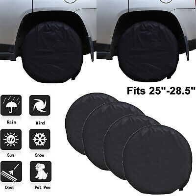

Another variation==
I've started to put covers on my wheels to keep rain and U/V out. Standard 17" & 18" tyres are 27" diameter
