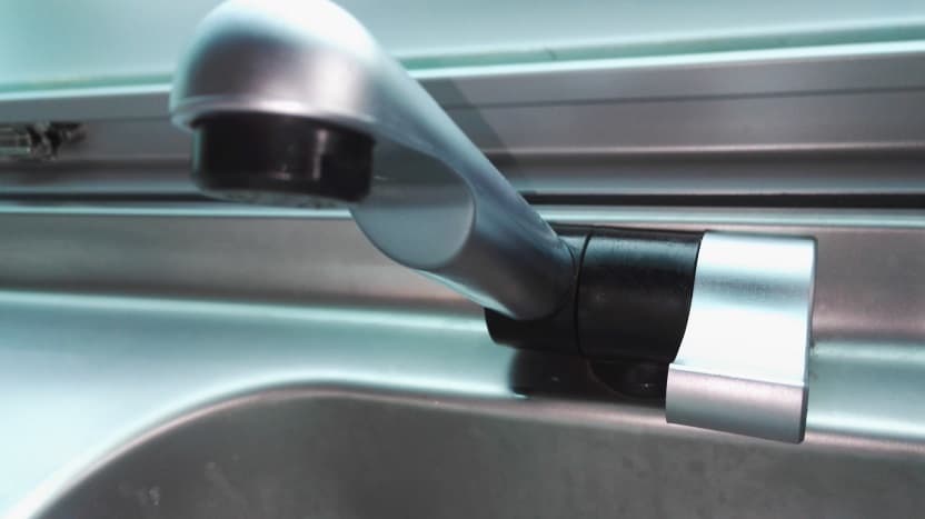

My Kitchen tap stopped working a while ago (I've done the old take it apart and clean the micro switch etc which fixed it briefly but now it doesn't work at all). So I bought a replacement which looks exactly the same but when it arrived it's a hot/colder mixer tap. The ebay advert says it can be installed as cold water only but I'm not sure how to do this. Does anyone have experience of this? Do I need to blank off the hot water connection to stop it leaking out of there? Also there are only two wires so I'm wondering if it works a bit differently from an electrical point of view.

Is the problem definitely the tap? Your pump could be on the way out. You can easily check it by disconnecting the plug near the tap and shorting the two connections.
Your'e right, I should check that. Thanks.
Checked the pump and it’s working. I’m going to connect up the mixer tap and see what happens but if anyone has any advice i’d Sure appreciate it.
That’s a good start. Can’t really advise regarding the tap. If it wasn’t too much hassle I’d return it and buy a like for like replacement. Unless you’re pushed for time that is.

OK. Getting the tap out - not too much bother, but I can't see how to disconnect the the wires from the old tap from the white plastic connector block. Is it possible to re-use this or do I need to cut it off and botch a new connection somehow?
I’d cut the wire on the tap side of the plug, leaving about 5cm of the original cable to join to your new tap. A bitch perhaps but a tidy one that still maintains the functionality of the original plug.
Duh. Not bitch, botch. Blooming autocorrect.
Hi
As mentioned in my other post, did exactly that. Job done.
