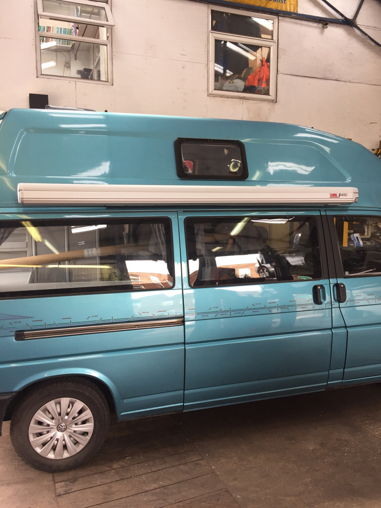

I'm looking for and struggling to find an awning rail that will fit my camper.
I've included a photo so you can see the problem.
I can either find something that will fit along the strip between the roof and the windows - which means screwing into the metal. Or alternatively, if you zoom into the photo, Westfalia have two sets of two bolts that are designed to take a Fiamma awning, is this an alternative to site an awning rail?

Yes, don't know what happened to text. Fiamma F45s 2.6M long

Three more questions
Did you attach with the Westfalia high top brackets?
Can you attract a drive away awning - which is what I want to do?
And finally, is it water tight behind the fixture?

Yes, attached with 2 hi top brackets, not water proof, there is a plastic angle section from Fiamma which can be fitted on top of the awning to make watertight. You can also get aside wall system to make into a room, i.e. Enclosed

Sorted! Thanks for the help!
