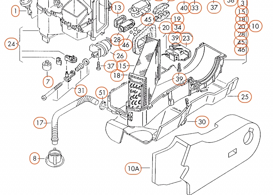

Think you’re on the right track with the Aircon evaporator drain. They get a few mentions for being blocked around the t’inernet. I think you’re going to have to get under the dashboard to locate it but hopefully this diagram may help you on your way…
Part 17 is the culprit you’re looking for.
Hello mrcheesebrough. Thank you for detailed explanation of this "water" problem, I have traced it to a (double) blockage in the air con condensate drain pi
Hello mrcheesebrough, thank you for the detailed explanation of this "water" problem - as you correctly said I have traced it to a (double) blockage in the air con drain pipe (part no. 17) just above the exit bung (spiders!!).
