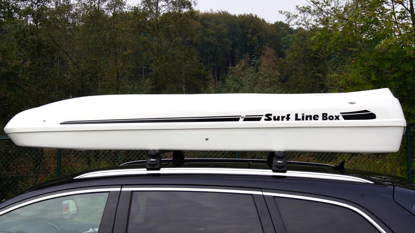

Why not a Roof Box designed for skis. Secure, out of the weather and avoids all the internal modifications.
(Move house…)
Seen these a lot in France, they do various sizes; would just need to watch the combined box + ski weight if you want to raise the roof:
