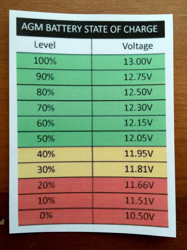

Ok in context I think I get it, so I need to proactively monitor the voltage on the battery with one of the devices you've mentioned, and when it reads 12.0V with nothing running, it's time to stop using it?
I do have one of the cigarette lighter chargers with the voltage on, and it's reading 12.9V at the moment under no load (and jumped to 13.6V with the EHU connected). Is that good/normal? I bought the van second hand, so I have no idea how the battery has been previously used. Is there a way of determining the health of the battery from these readings?

The voltages shown are fine.
And to your last question YES.
If you have a factory fitted Parking Heater then that will switch Off if the voltage drops to 11.5v during use. Otherwise, on the Beach T6, you have to monitor the voltage with a bought 12v plug in Voltmeter to avoid running battery too low.
Exactly. And as Andy has said treat the voltage as a guide. AGM batteries are a bit tougher than old flooded batteries.
