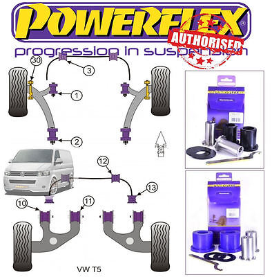

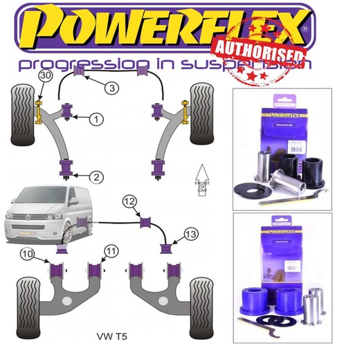

Powerflex...all adjustable (apart from front camber as this was supposed to be range) - front and rear. Mine is lowered circa 50mm
Didn't replace the roll bar bushes as these were fine.
Fully adjustable kits available for front (caster & camber) plus they also do adjustable rear camber ones which are ideal for lowered vans to reduce the inner tyre wear . T5 & T6 are the same.
