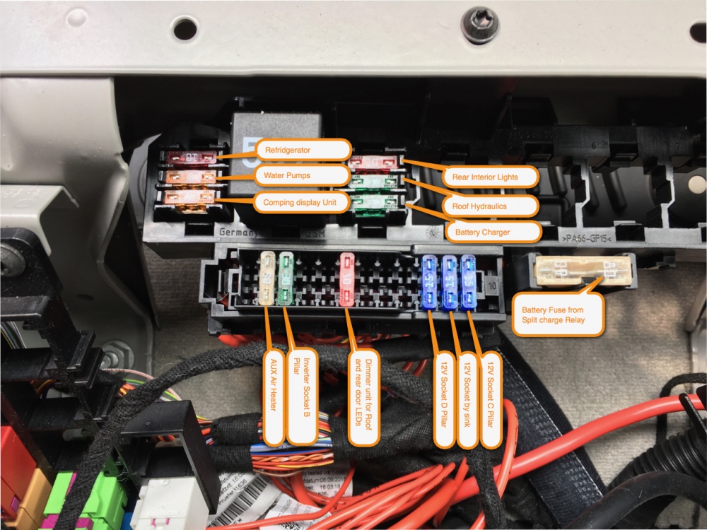

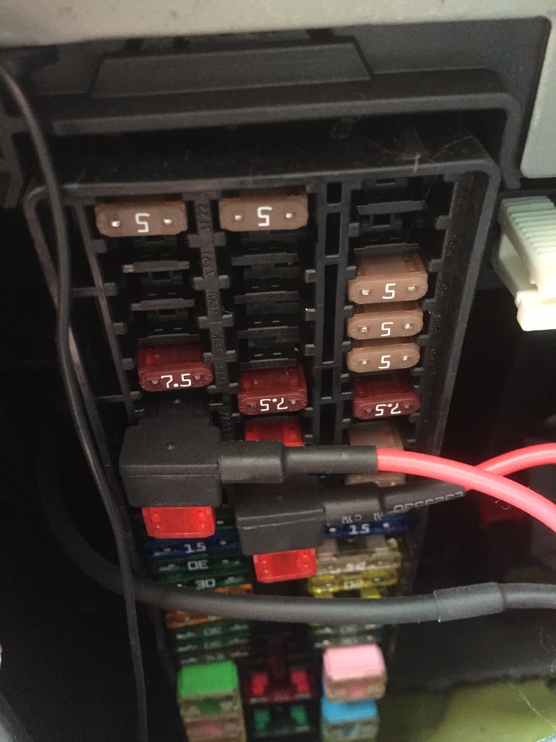

Something I found useful was making up a note on my iPhone called Called Cali Stats where I keep a record of the vital statistics and pasted in pics such as below
This one is the fuses under passenger seat on a RH drive.
This one of an Ocean

Here is another one I made.
I spent ages searching for something like that the other day. I was trying to locate the 15 amp fuse for the cigarette lighter, and pulled the top 15amp fuse, and then forgot where I'd pulled it from- doh.
Eventually I found an unlabelled photo.
What an excellent resource.
I've also managed to confirm that the Beach socket labelled 'max 20 amps' has a 15 amp fuse. That seems a bit odd to me. A bit like a motorway sign saying max 70 mph then penalising a motorist for exceeding 50 mph.
Excellent detail for both fuse boxes. Copied for future reference. Just in case
Such helpful reference pics to put safely in phone folder - thanks for the idea!
