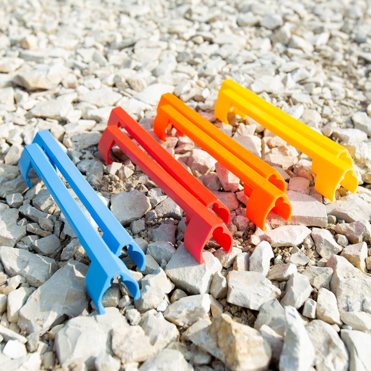

I am going crazy searching for an item I found to buy later online and now can’t locate. It was a catch that fits on the struts to hold open the tailgate that was released with a catch to lower. They were available in a variety of colours if that helps jog someone’s memory. If anyone has seen this, would be grateful to be pointed in the right direction! Thanks
I think that the company was SGS, who supply and re-condition gas struts.
Thanks @briwy and @Vagophile these things were clips that live on the strut permanently. Hopefully I will find the site at some point!
They have one in this u tube clip, I want one too but
their website is unplugged whilst they are on holiday.
Thank you! I am no longer convinced I am losing my mind!!!

Well the shop is open, but the product is out of stock!

Spoke to them yesterday, they are trying to deal with new rules for shipping outside of Germany. Apparently my rear slide was ordered in time abs will go but new orders are Germany only so you may get lucky soon.
I don't like using them, however some times they have saved me time when I was on my own and had the bicycle loaded. Here in Barcelona there's a shop that sells all sorts of aluminium profiles. Years ago I bought a bit of this U shape profile and made them for the T4. Yesterday I had to cut about 3 or 4 cms (I marked them, didn't measure) and can now use them in the T6.

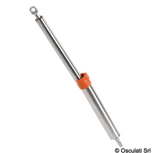

Just bought a few of these https://motioncontrol.metrol.com/10mm-metal-safety-locking-tube.html of different lengths to suit different tailgate opening extents. £5 each so thought i would see which works best. I figure having the tailgate less far open will reduce mounting load.
I found one from a shop in Germany which I keep in place all the time. Good news is tailgate happily stays up this time of year. View attachment 127178
Can you please let me know which ones you exactly have, and how did you mount them? Thanks! Especially during wintertime, it's super annoying and the car is like 6 months old.
