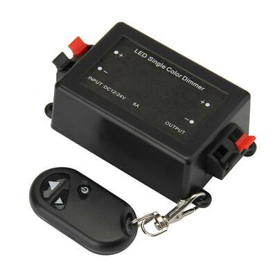

I was wondering if anyone has experience of the Thule OEM led light strip which fits into the recess on the awning. It looks pretty good, but for around £80 the spec is somewhat lacking. For example, how is it controlled? Is it dimmable?

I built one with bits from ebay. The rf control can dim the leds and switch on of by remote. Choose 12v led strip, waterproof and sticky backed in colour of your choice and wire to 12v cig socket in boot. Search for rf led controller
I took a feed from the cig socket and fitted a switch and fuse in the boot to prevent battery drain when sat on the drive. Belt and braces
