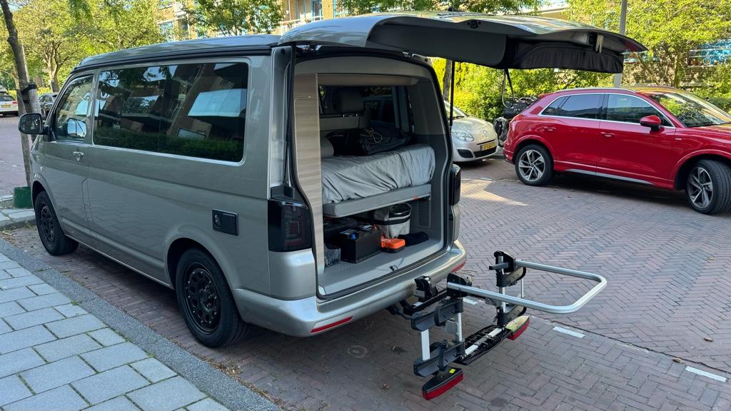

Hi
Are you able to post a photo?
Thanks
Here you go. Its a quick, easy and not so elegant solution but it has worked well on both a Caddy and the Cali. We have the removable type towbar. After the rack is fitted to the van and still empty, tilt the rack and use the upright as a guide against the bottom of the Cali tailgate. Adjust the rack so that the tailgate clears, then lock it onto the towbar. Once this is done, the rack when loaded is still at a good angle and horizontal with the vehicle. It doesn't interfere with the locking mechanism in any way.
Another option would be to ask a yacht chandlers to make up another longer cable. The bolts were ordinary metric with nylock nuts. Thanks for asking about this and I'll do a bit of pre-winter corrosion protection on it all!
This has been strong enough to support two e-bikes when tilted and the bars are still off the floor.
HTH.

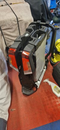

Its a Buzz Scorpian Lite 2 - very good but just catches the tailgate!!
HTH.
