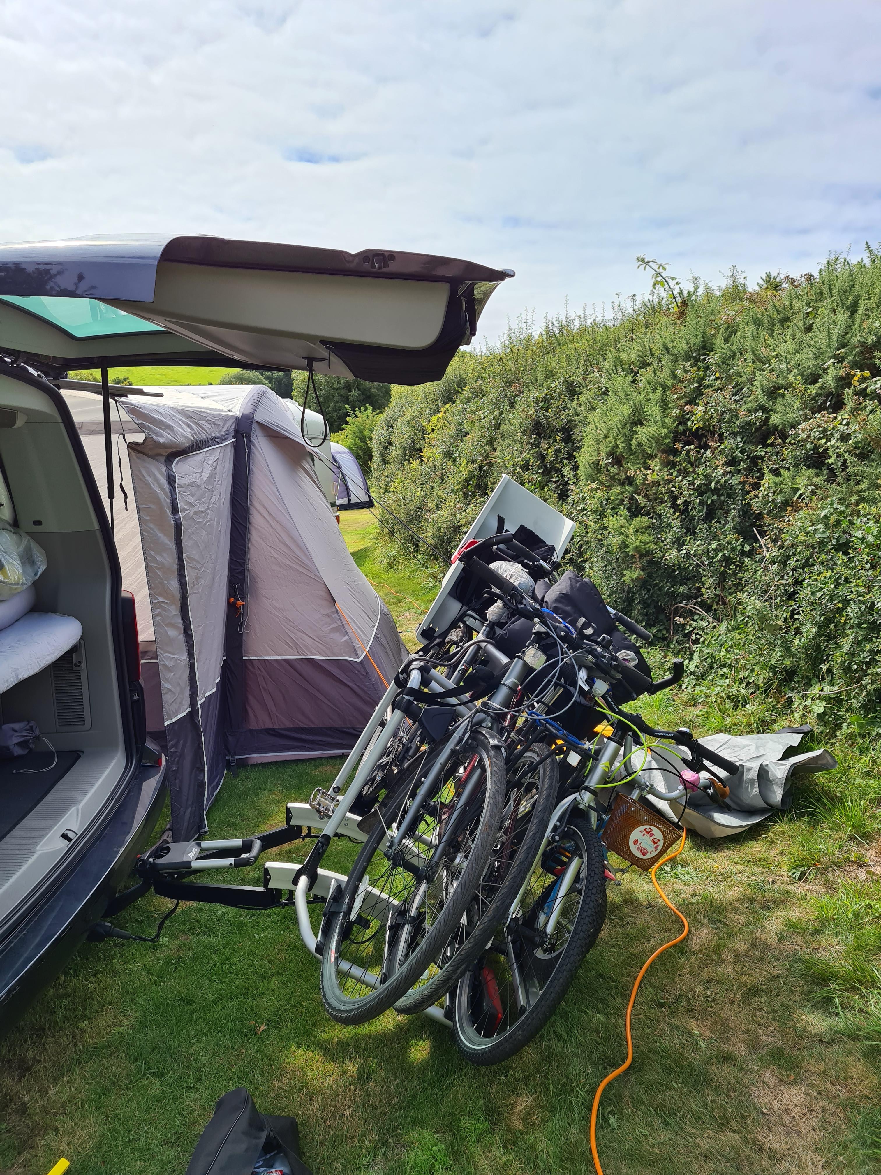

My Atera Evo Bike rack fitted my T5 and the rear door could be opened once the rack had been slid back. The detachable tow bar was an after market one. My new T6 has the VW detachable tow bar and, on full rearward travel it does not allow the door to open, I have tried a number of times without success, the rack simply sits too high? Is there something I am doing wrong? The standard VW towbar is a Westfalia.
We have an after market fitted VW Westfailia tow bar and the Pro User Diament SG2 Plus bike rack with a tailgate T6. Bike rack tips with plenty of space to open the tail gate. Must get the Plus version as the plain SG2 does not work. Available from Holland Bike Shop.
I bought the Atera Strada DL3 since my last post. Drove 900 km with it and found it fantastic.
Easy to load, super sturdy, and little if any effect on handling.
I have the removable Westfailia tow bar: as others have commented, the rear door clears the rack (barely), and rotation of the handlebars of the bike nearest the vehicle is necessary to open the rear door when the rack is loaded. Havent used the VW rack for comparison, but wouldn't hesitate to recommend the DL3.
+1 for DL3
I have to agree.
We use DL3 with 4th bike extension on a Westfalia detachable tow bar (haven't removed it yet!), we rarely remove the rack from the tow bar on a trip and store the bikes on it overnight.
The main point for me was access to the boot fully loaded on day trips and short overnight stays and the Atera allows for this.
I also wanted a low rack for loading and it's even easy enough to use for my 10 year old son to load the bikes safely.
