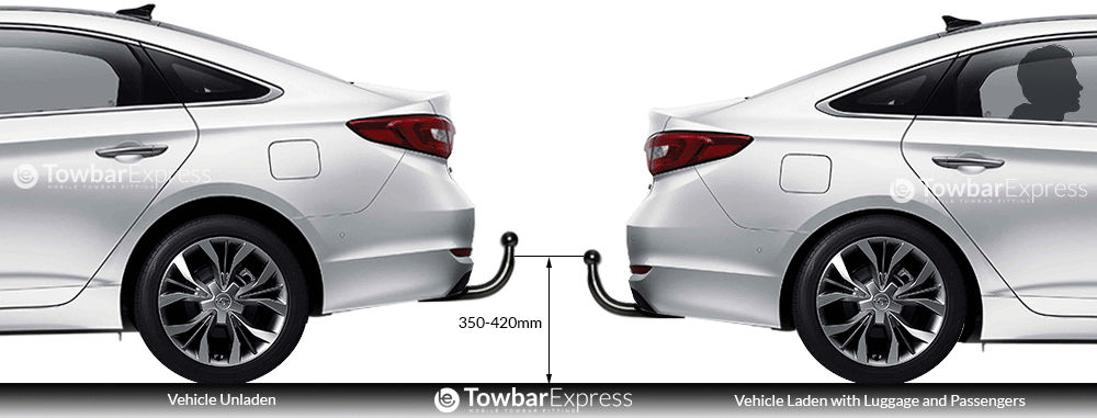

The EC Directive 94/20/EC (The standard that all towbars are designed to) states that the tow ball height should be between 350 and 420mm from the ground with the vehicle in a 'laden' state.
As long as the Towball height is within that range, and the Caravan is EC compliant there should be no problem.
