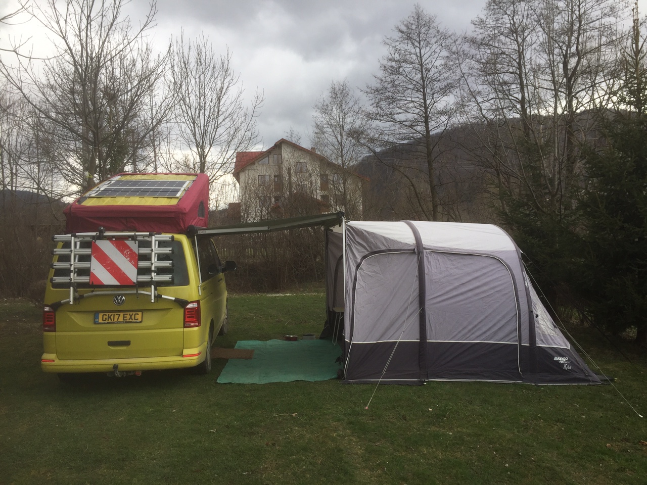

We have used our Vango Kela III extensively in heavy rain.
We usually use it with the wind out awning fully extended, sometimes with side panels, but this set up means the huge porch area cannot be made fully weatherproof.
To prevent rain pooling on the wind out awning and the Kela porch area we fully extend the wind out awning legs.
Over the year, the seams of the Kela have lost their waterproof, but this could be remedied with seam sealant. In heavy rain we get drips, but no pooling on the tent and no serious flooding except in the huge non weatherproof porch area. We mitigate this with a tarpaulin, a better mitigation would be interlocking awning tiles.
Our Kela connected to our van with a massive porch area without side panels.
I notice your Vango is nice and level on the floor, what’s your secret as mine always end up raising an inch or so where the vango writing is on that end......maybe I’m trying to pull it all to tight from the van. Also is it possible to drive away with it connected to the porch? Or would this be a 3 persons job.
1. Make sure the awning legs are fully extended and perpendicular to the front of the wind out.
2. Peg the groundsheet to the awning leg feet.
3. Pull the groundsheet tight and peg at rear.
4. Attach awning to the front of the wind out.
5. Peg out front of awning keeping adjusters slack.
6. Peg out rear of awning tight to front.
7. Inflate rear arch to full pressure.
8. Inflate front arch to full pressure.
9. Peg out arch feet, and two rear points.
10. Insert roof support
11. Peg out rear straps and 4 guys.
12. Wind in the wind out to fully tension.
13. Tighten porch adjusters.
Method has been developed and refined over a years' near continuous use and I continue to refine.
Detaching for driving away is easy and a one minute 1 person job.
