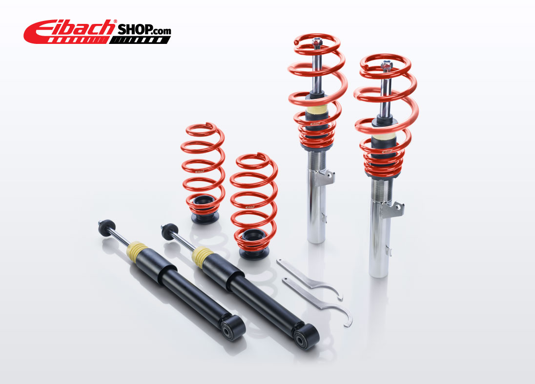

Does anyone know the correct part numbers for the vw approved Eibach Coilovers to fit a 6.1 Beach?
Am told they are the T30 version, but dealer won't give me the part number (so I can't work out just how much they are trying to rip me off)

Eibach set for California 2017 : TU-024780-L0-024 order via Ebay.de much better price!!
And no need for alignment! Do a search on Ebay.de for best price!
Thanks, so this one: https://eibachshop.com/index.php?p3...sporter-v-box-transporter-v-bus-transporter-v
Front axle load is only 1550Kg, which isn't enough for a T6.1 California Beach Camper (I don't think)
However, does show the markup that VW charge. Strangely, when I spoke to Bognor Motors, he called VW to get the price - implying you can only buy them through VW?
Perhaps it is this one:
Which is €1,520.35 RRP - more inline with what VW charge.
Or this one
The above two appear to be almost identical (one has 01 in the part number, the other 02). The cheaper one mentions "Not for "T32" - Vehicles with double bolt McPherson strut. - Only for vehicles with strut-clamp."
Based on the information in the installation instructions the two models have different front coilover struts (the springs, and rear shock all have the same part numbers on both). The different front strut means that they have different max / min adjustment values; however both quote the same weight rating and lowering range on their respective pages,
From what I have read, a T32 has a different fitting, requiring a different front strut, so I *think* that the '01' is for the T28 / T30 and the '02' is for the T32. Just a little confused, as I thought I read that the T32 was the one with the strut-clamp, but Eibach website says the '01' model is not for a T32, it is only for the vehicles with the strut-clamp??
