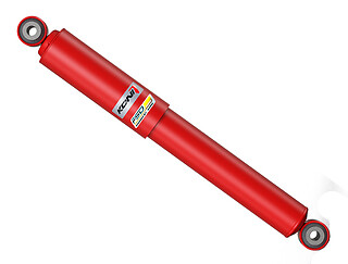

From conversations I think the options that give the best ride at each height are
Koni Special Active Shocks with -40mm springs
Koni Sport Short Shocks with -50mm springs
Eibach Coilovers at -60mm (VW Warranty friendly option)
KW/H&R Coilovers at -60mm (aledgedly better ride and definitely cheaper)
Appreciate there are other options and brands, but these are the ones I've narrowed it down to with all the non Eibach options recommended by CRS, the Eibachs are only there as VW approved.

Can anyone recommend best shocks to run with the H&R 40mm drop springs? Need to replace standard shock on the bus for something a bit less choppy.... Though these might be good?
Choppy is normally due to stiff damping but as you have standard dampers it would normally give a 'bouncy' under damped ride when stiffer lowered springs are fitted. In effect a mismatch of damper-springs.
Koni Active may be the best option.
