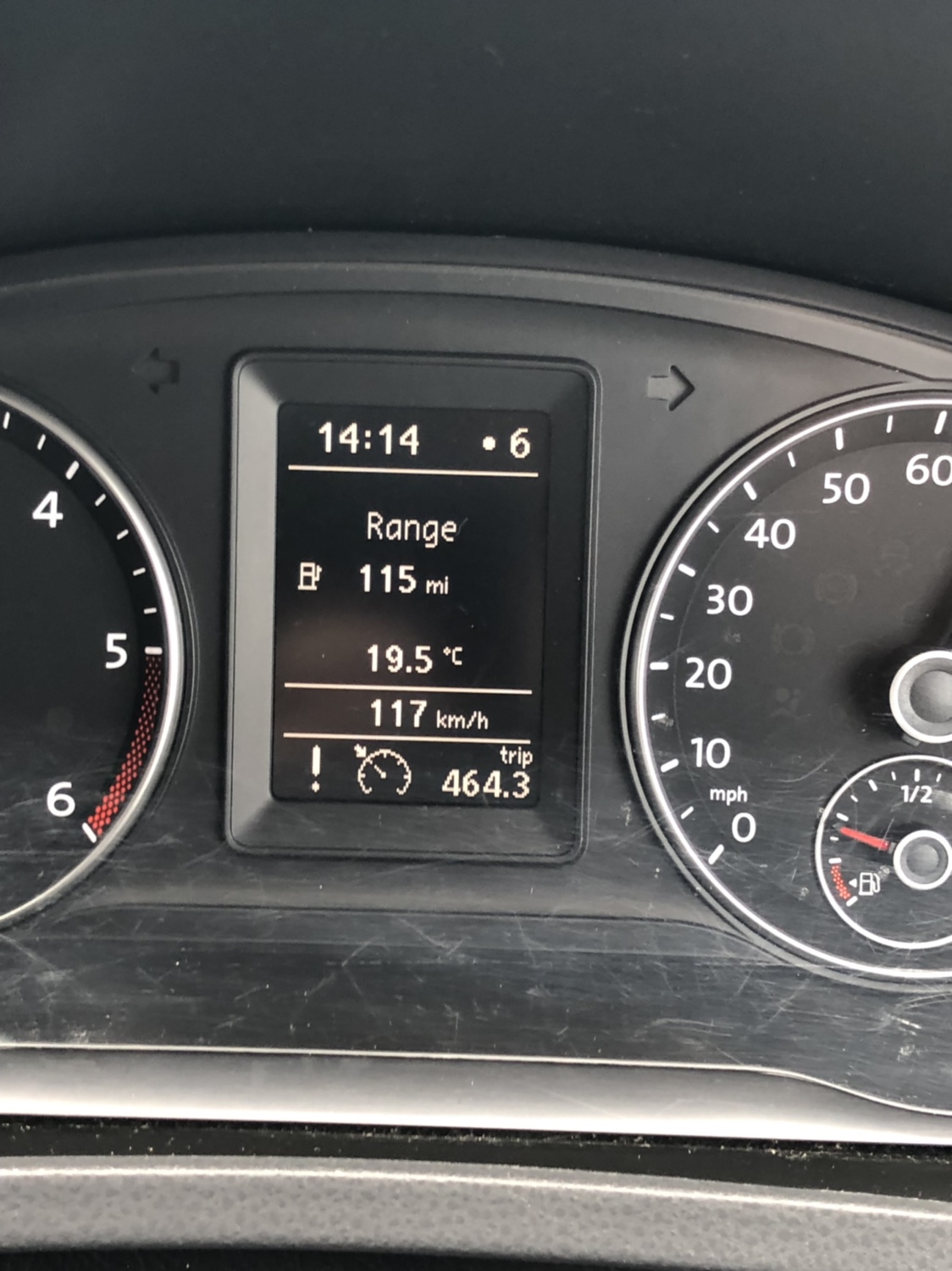

Collected my van today after having a new BCM and they’ve now killed my cruise control!
It no longer works and I have an exclamation mark where the mileage should be.

I’ve attached a picture of the exclamation mark above, never seen anything like it in my life!
