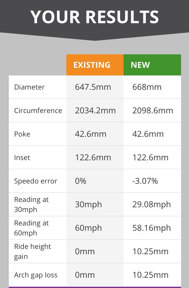

Interested to know why the small change? Anyway an online calculator gave these results for speedo error, Ride height change etc.

An interesting dilemma. The change shouldn’t have any effect on your ABS. As you can see by the comparison the most major change will be the speedo accuracy.

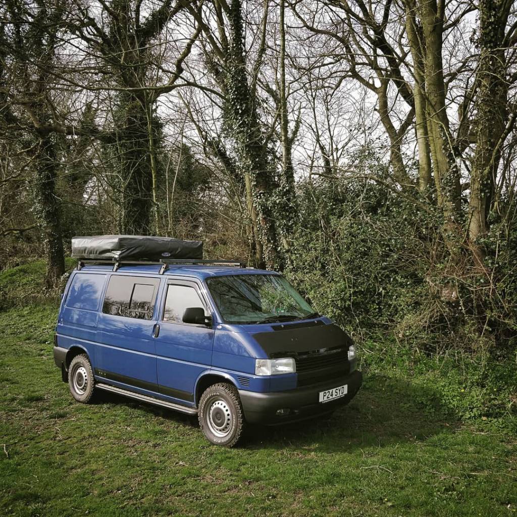

You should be fine with that size. I run 215/75 on std 15" vw steels on my other T4. That's as big as you can go without modification. The Speedo on mine reads perfect now against the sat nav.
Sent from my ONEPLUS A5000 using Tapatalk
So you have no problem with the abs system?
