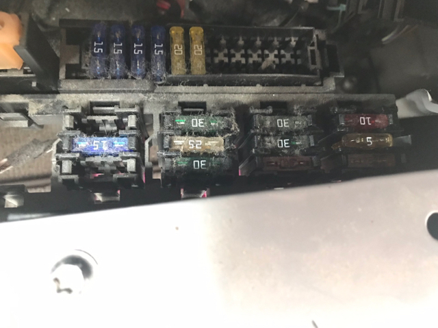

Using a multimeter, when tap is on, no reading at the pump cable connection point under the hatch in the wardrobe.
If I disconnect the connection under the sink and bridge the contacts, pump does not fire up.
Can only assume I am looking at the wrong fuse, on the photo below can anyone please advise which is the correct fuse for the system. T5.1 2010. Thanks.

According to my information it is a 5 amp Fuse at position SF20, far R middle Fuse.
Yes mine was fuse 20 under passenger seat .. took a little while for my little head to turn the seat 90 degrees to get full access to fuses .... derrr
