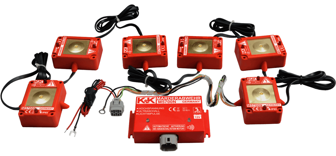

I was looking under the van as it seemed a lot of water coming from the air conditioner
anf I found this red box with two flashing lights
Do you have any idea? What is it?
Tx

Looks like a speaker symbol, might be an alarm sounding unit but for what?
tracing the wire back seems the only method to uncover it's purpose.
Have a look under the front wheel arch over the top of the tyre at the suspension strut, if a steel spring there then normal suspension but if a rubber bag of some sort then it has air suspension but should have a control unit panel inside or a remote.
With a start from above i found this being an anti rodent system, like having a dedicated cat to guard the Cali. First time I've come across such a device.

The red box is indeed ultrasonic anti rodent.

I admit I did’t know about martens problem, which seems to be a quite big issue in alpin countries.
By the way, I had a deeper look at the system
And the switch that automatically cut the voltage when opening the bonnet... hopefully

Don’t know if it’s effective, but The previous owner was a guy living in the Alps, so it seems to be a real problem.
I took some information, this model is very well sold in Germany, switzerland and austria
