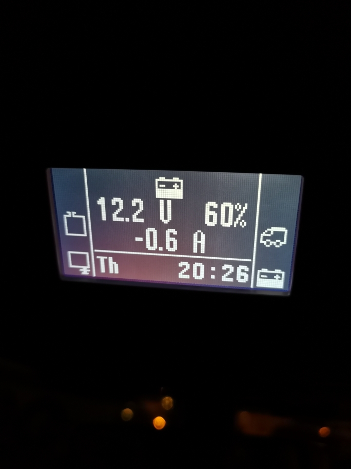

Hi all. Currently sitting in my van. Everything is switched off (apart from the console) but the display is still saying -0.6A.
Any idea what could be drawing current?

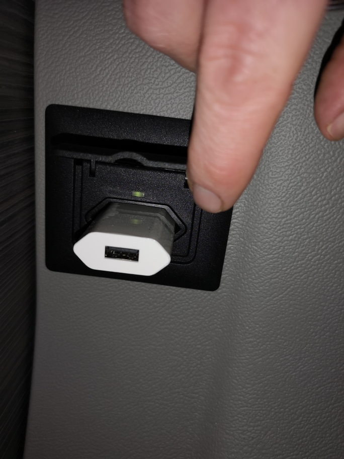

Any 12v USB chargers left in a socket?
Check the Inverter is not on. Open the flap of the mains socket at the bottom of the passenger B Pillar.
Is there a LED light top left. If on and green in colour, I think, this indicate Inverter is powered up.
can you switch the inverter off?
When you plug into the Inverter Socket then a small microswitch is depressed, L upper side , which switches the Inverter On. This switch can occasionally stick On.
The only other way to switch the Inverter Off is to remove its fuse. 30 amp fuse under front Passenger Seat.

Thanks for the replies. Is the inverter socket the hexagonal socket behind the passenger seat?

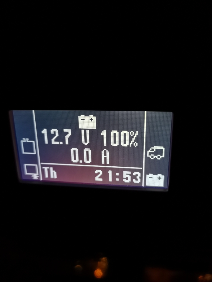

Yep, that's what it was. I'd left a USB adapter in there. It's now fluctuating between 0.0A and -0.2A.
Great stuff guys. Thanks again!
I had exactly the same experience, albeit was the slight whirring noise driving me mad during the night which led me to the inverter socket. Good catch.
Wow I didn't know that I leave my adaptor plugged in all the time and having just checked it I see the green light is on .....thanks for the tip it's now unplugged!
