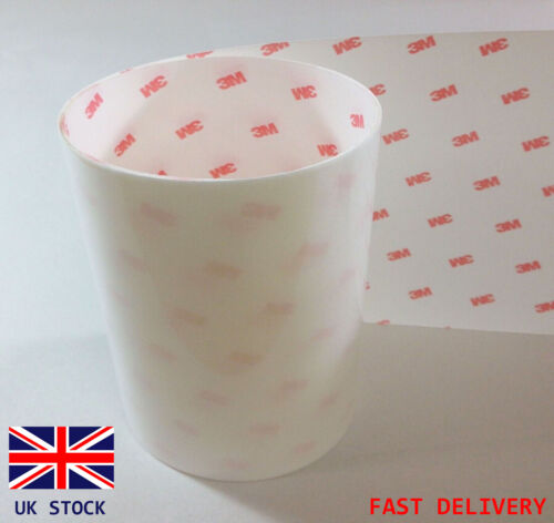

It's 99% definitely clear. The ebay option will be fine. It's super easy to install, just remember lots of water when installing.

Buy the part and stick it on yourself or maybe DIY using some helicopter tape?
