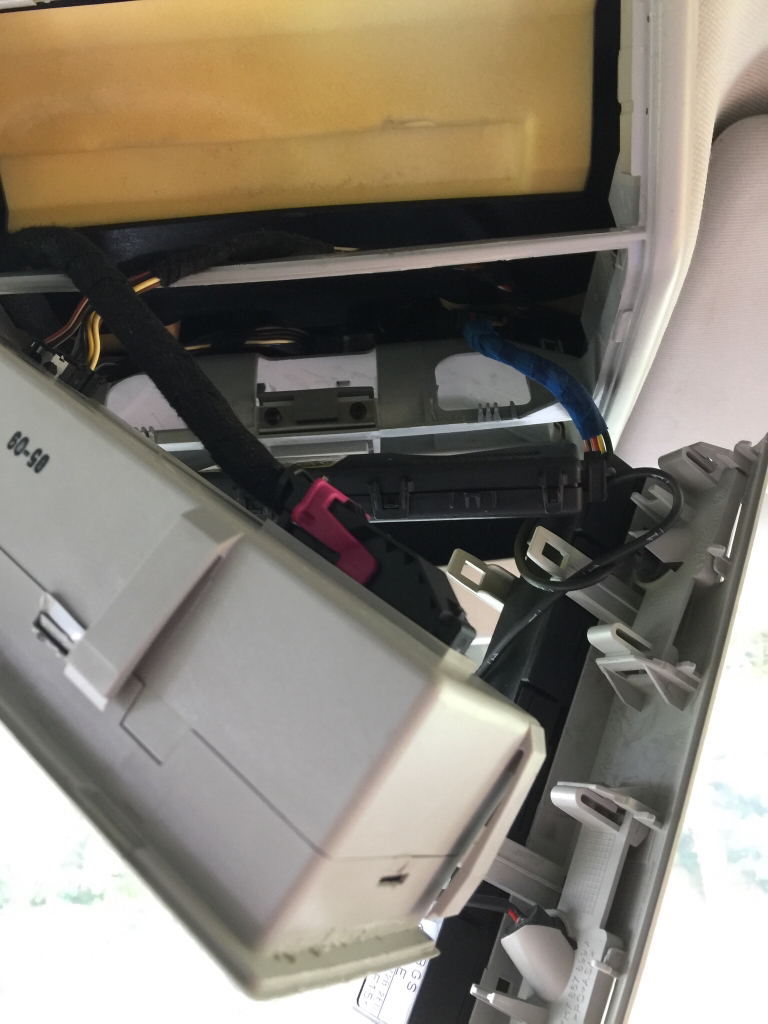

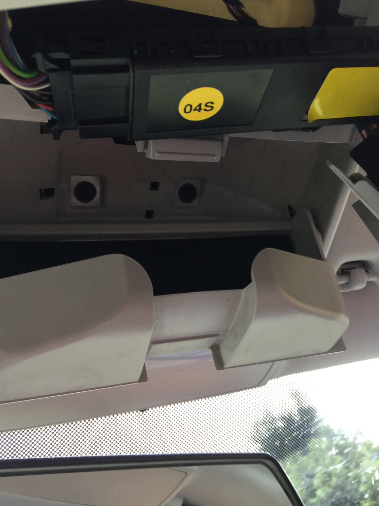

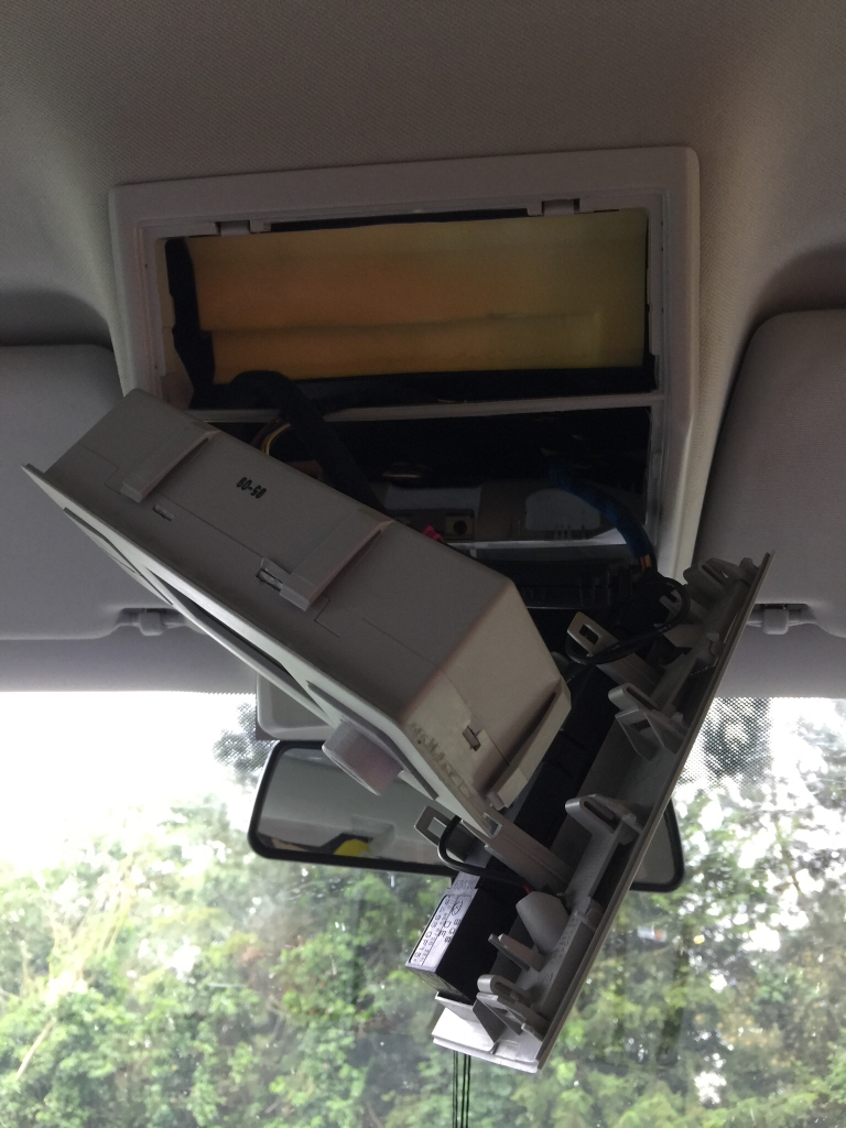

I'm 200 miles from home and the control panel button has failed. It won't 'select' when pressed so I can't access the roof menu. I'm therefore trying to lower the roof manually. Can anyone tell me which screw to turn please?
My manual states it should be where the yellow foam is behind the control unit?

It was easier to strip the unit out, open, reseat the control button and reassemble. Result. All functioning as it should. Am intrigued to know where the screw is though if anyone can point me at it. Thanks.

Behind the Foam.
In my post above but only behind the foam.
I'd fixed and reassembles before reading this. I didn't tear the foam out so no pic am afraid folks :-( it wouldn't be easy to get the foam out. Probably take a sharp knife so not returning in original form I'd say. Also the manual says steal the roof down and go direct to your VW dealer at 60kmh and with your wallet wide open. Not my bag!
