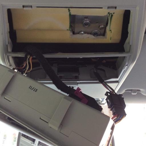

In an attempt to get some use out of the cali we've had the pop top up for a couple of days on the drive and this morning when I went to close it (impending rain), the control panel is not responding to Close or Open. It flashed up something briefly about the roof being in an indeterminate or intermediate state but that hasn't come back. When looking at the roof from the outside I can see it's dropped a fraction on the offside. Used a hop-up to take a look at the mechanism I can see the offside mechanism is 10-15mm back from being fully engaged. Nearside is fully engaged.
Referring to the manual there is a section on lowering the roof manually. So I followed the very poor instructions as best as I can and removed the panel housing the emergency buttons, exposing the foam above. I've had to pick all of this out in pieces until I finally find the hydraulic mechanism. Referring to earlier model threads on here I find what looks to be the equivalent of the brass screw (although the new one looks to be silver in colour but in the same position). It's incredibly tricky to reach but I have one screwdriver that is just able to turn it. I loosened it 2 full turns and nothing happened so I've tightened it and now looking for some advice.I've attached some pictures below showing the hydraulic positioning and the super difficult to reach screw. I'm utterly bemused at a system that involves having to spend 2 hours trying to find a screw just to try and lower the roof manually. The manual makes it sound so easy and the photo bears no resemblance to what needs to happen it seems.
I've called my local VW dealer to see if any of the technicians are working but understandably they're working on a skeleton crew.
Any thoughts aside from just torching it on the drive and walking away, as that's how I'm feeling :rolleyes:
View attachment 60265View attachment 60266 you can see this one isn't fully engaged, although it was all good when we raised 2 days ago with the canvas taught.
View attachment 60267View attachment 60268View attachment 60269View attachment 60270I believe it's the screw that you can just see on the left with the yellow paint dab. Super difficult to reach.

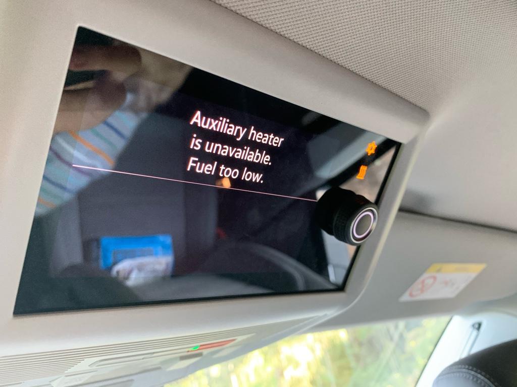

Hi Everyone!
I had a software hickup in the controlpanel today (it got stuck in the warning message; see image) and hence I got stuck in the wild with the roof up.
The only way to restart the panel (according to my local VW dealer) is to unplug the extra battery located under the drivers seat. You need a wrench size 10 and voilá, it restarted and worked!
Maybe this helps someone...
/S

Hi Everyone!
/S
Skickat från min iPhone med Tapatalk
Hi - I got that same issue this week - stuck in that screen and could not do anything - I have reset the control panel by unplugging fuses 5 to 8, wait a couple of minuts and plug them right in again - that worked as well. It does seem however, after resetting, you need to drive a couple of miles for ALL systems to reset, at least, that is what my dealer told me - thanks for the tip on the battery, will give that a try in the future!
