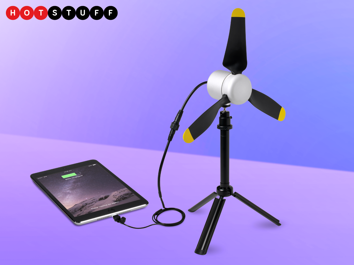

Slightly off topic, and for use of a different purpose, but can anyone recommend a good wind turbine?
I have a 12v wind lily on pre-order, the water lily is an excellent robust little turbine, I hope the wind / water version will be as good.
I’ll review it when I receive it.
The waterlily looks really interesting Douglas. Thanks for posting. Have you written a review for it? Would seem to make sense to wait for dual purpose water/wind version.
