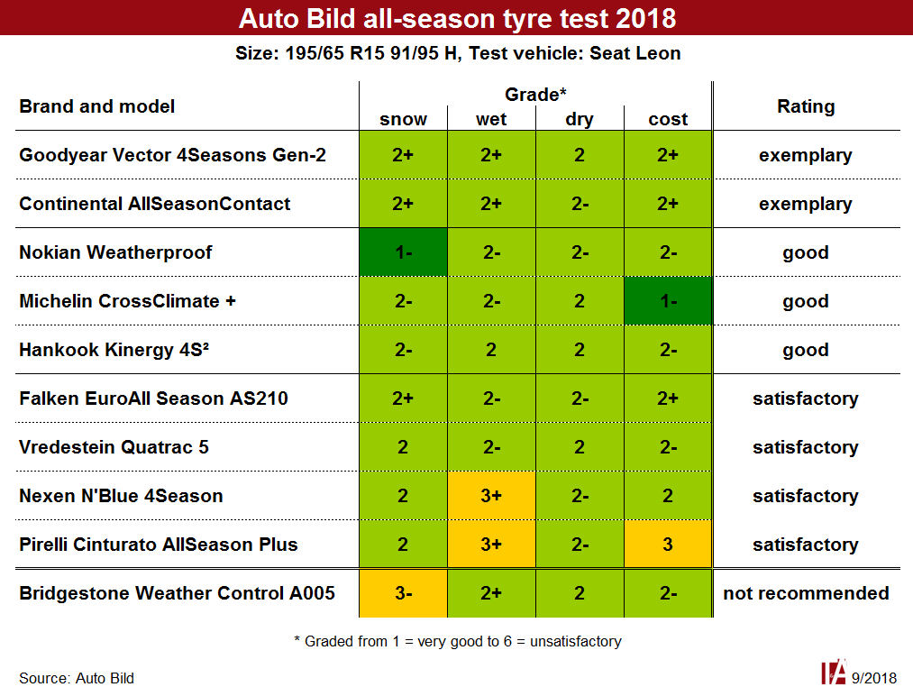

Not as good in this test ?
2018 Auto Bild All Season Tyre Test
Following on from the 27 all season tyre braking shootout, Auto Bild have published their excellent 2018 all season tyre test. Testing the best ten 195/65 R15 all season tyres from the braking test, Auto Bild have done an incredibly thorough job putting all the tyre patterns through the usual array or dry, wet and snow testing.
The New Tyre
The most interesting part of this test must be the inclusion of the new Bridgestone Weather Control A005, as it's the first time this new tyre has featured in a full all season tyre test.
If you're just looking at the results as the overall standings, you'd be forgiven for dismissing the Bridgestone as a purchase option, but for the most of the UK this new tyre might actually be one of the BEST options for year round motoring in the UK.
Why? Because it has significant advantages in wet and dry braking, even beating the dry master the Michelin CrossClimate+, and matches the excellent performance in dry and wet handling. While it's snow performance is it's weakness, it's still significantly better than the reference summer tyre in the test. With the UK climate being dry or wet 99% of the year, the balance of performance the Bridgestone offers is more acceptable to our climate than it is to the German testers.
